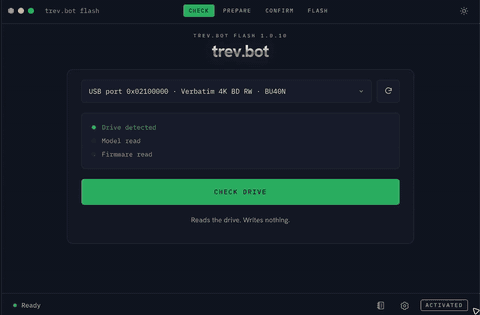

LG flashing is FREE right now — $0.00. No license required.
trev.bot 1.0.11 is out.
LG support. Cross platform. AutoFlash: check the drive, the app picks the firmware and flashes it. No more per-flash license. One license, three computers, all your devices. LG flashing is currently free during the introductory period.
Introductory price is $19.99 (regular price $29.99), LG and Pioneer flashing included. If you already bought a flash, your license has been upgraded automatically.
Also: OpenRipper, my free, open source auto-ripper. Put a disc in and it rips to your own storage, with a web dashboard to follow each drive. It uses MakeMKV to read discs, it's early days, and it doesn't need a flash license. github.com/redharp/openripper
https://trev.bot
PS: have a look at the appearance options in Settings. There's a retro Chrome look in there that I'm a bit too pleased with.
1.0.11 brings clearer flashing progress, a Check another drive button, and fixes for delayed check results and unnecessary repeat restarts.
Watch a real LG flash on my Mac.
https://trev.bot
