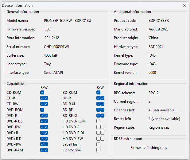

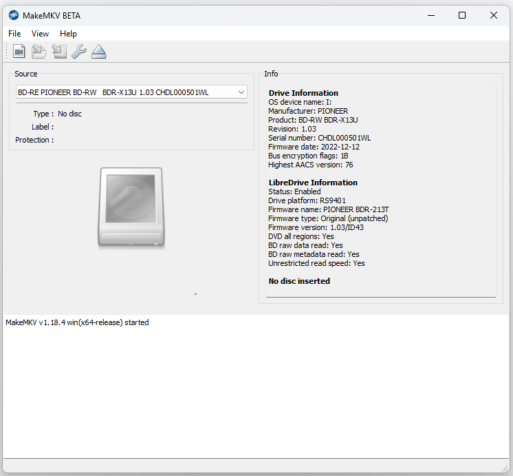

Can also post a success story with my X13EBK 1.04 now crossflashed to X13U 1.03 firmware. Drive now reads 4k discs in both MakeMkv and XReveal no problem.

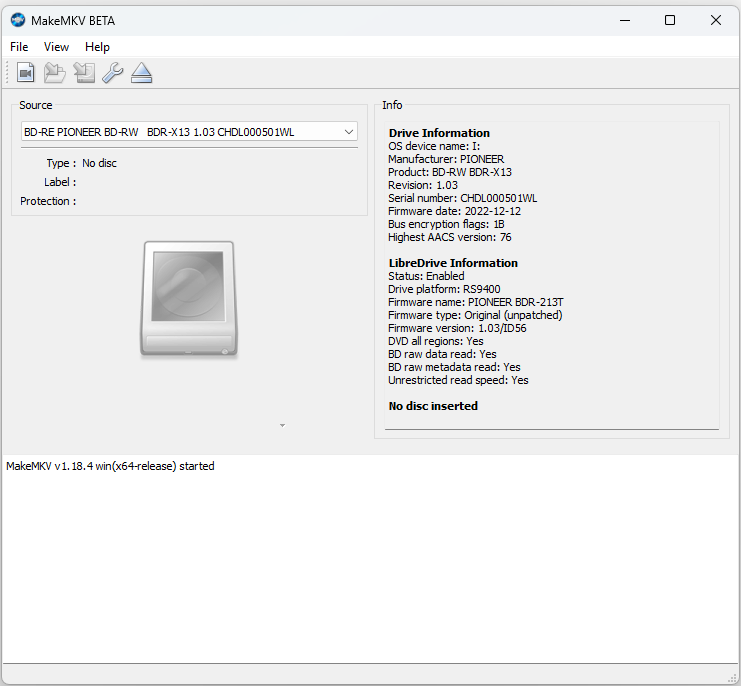

Today, we successfully crossflashed a Pioneer BDR-X13EBK 1.03 to the 4K UHD capable BDR-X13E-S 1.03 firmware.
Before crossflash:
Image Image
After crossflash:
Image Image

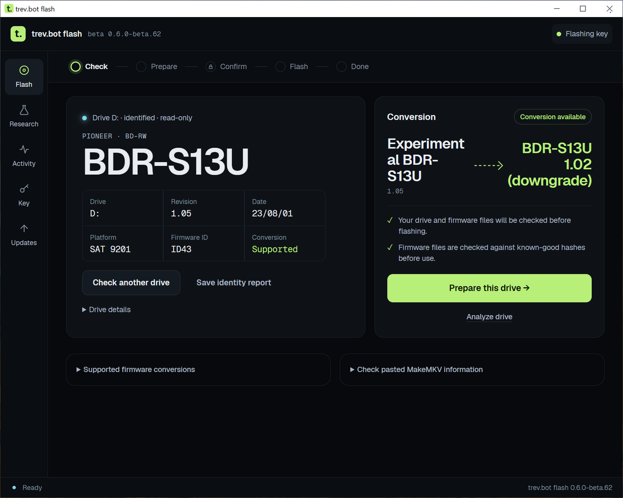

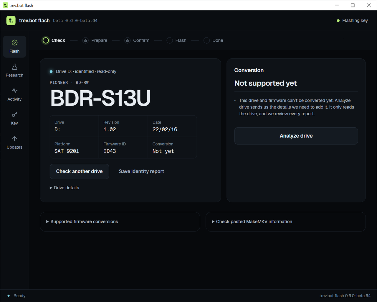

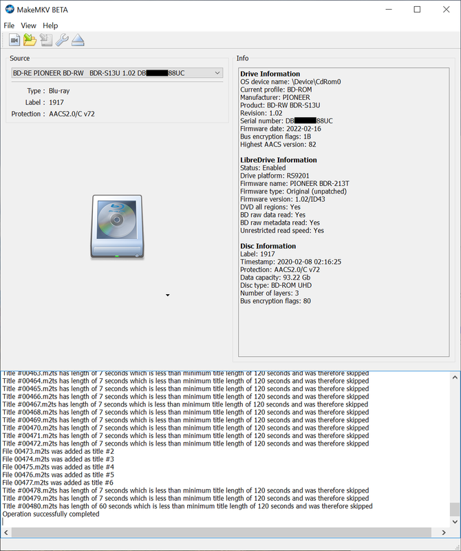

I'm happy to report the first successful FW downgrade of a Pioneer BDR-S13UBK 1.05 FW (2023-08-01) to 1.02 FW (2022-02-16) using Trevor's Trev.bot flashing tool. The downgrade to 1.02 FW re-enabled support for OWC enclosures in MakeMKV!
Pre-Flash:
Post-Flash:

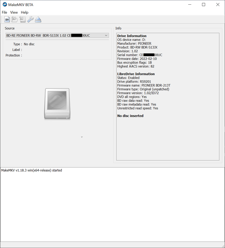

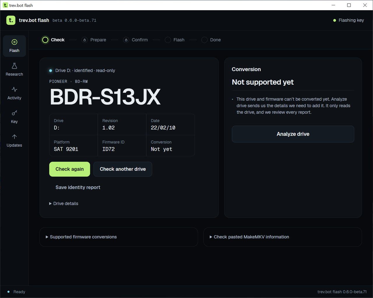

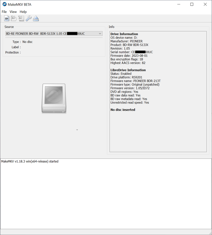

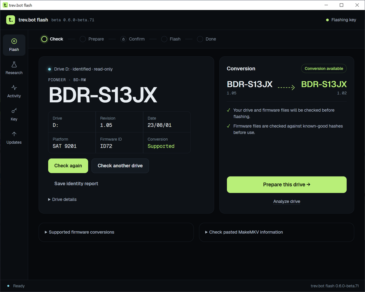

I'm ecstatic to also report the first successful FW downgrade of a Pioneer BDR-S13U-X w/ S13JX 1.05 FW (2023-08-01) to 1.02 FW (2022-02-10) using Trevor's Trev.bot flashing tool. The downgrade to 1.02 FW re-enabled support for OWC enclosures in MakeMKV!
Pre-Flash:
Post-Flash:
