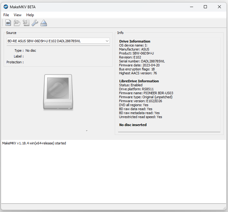

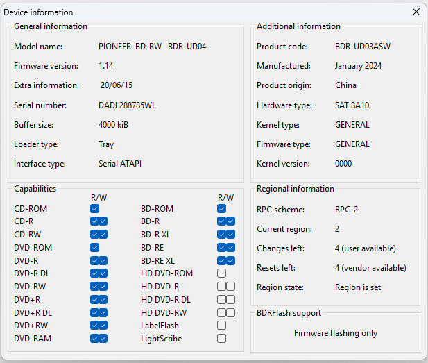

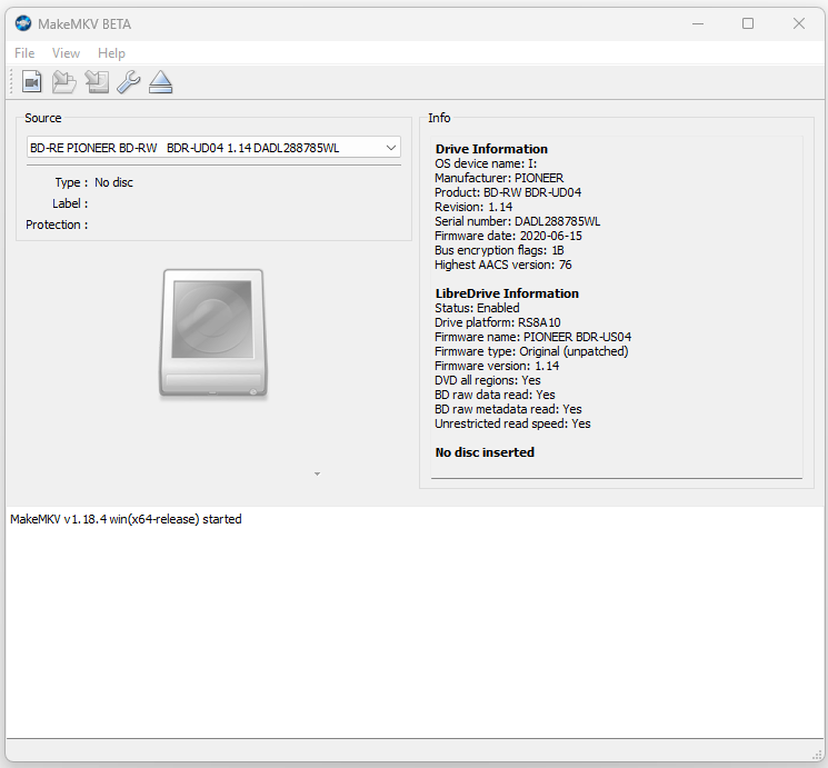

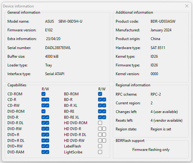

Thanks to Trevor's persistence and hard work, the first ever crossflash of a BDR-UD03 drive with 12/22+ firmware to BDR-UD04 1.14 has been successfully completed.
Starring: ASUS SBW-06D5H-U E102.
Before:
Image Image
After:
Image Image

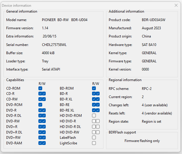

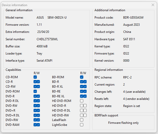

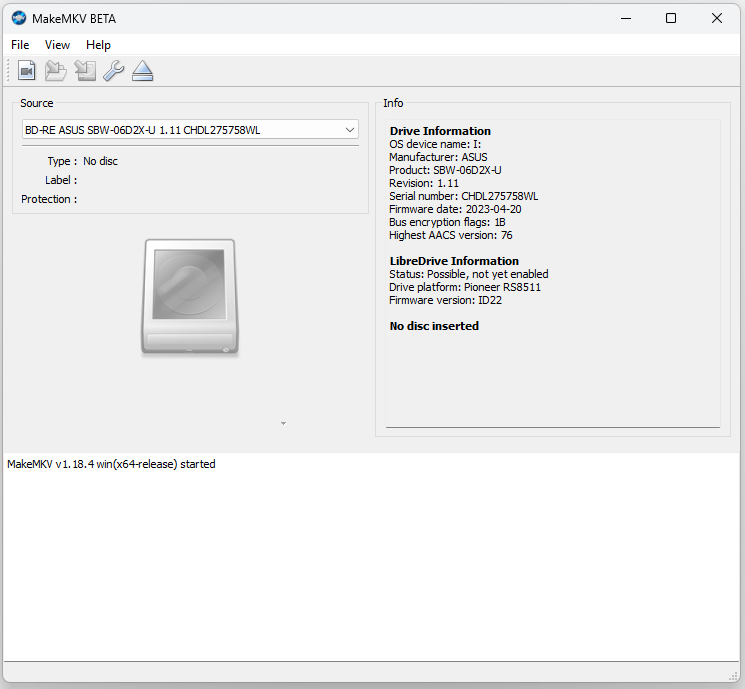

Another successful crossflash.
This time, an ASUS SBW-06D2X-U (BDR-UD03ASW) with firmware ver. 1.11 dated 04/2023 was successfully crossflashed to BDR-UD04 1.14.
Before:
Image Image
After:
Image Image
At this point, I would like to sincerely thank Trevor for the time he dedicated to helping me and for the countless tests we carried out together in support of this project.
