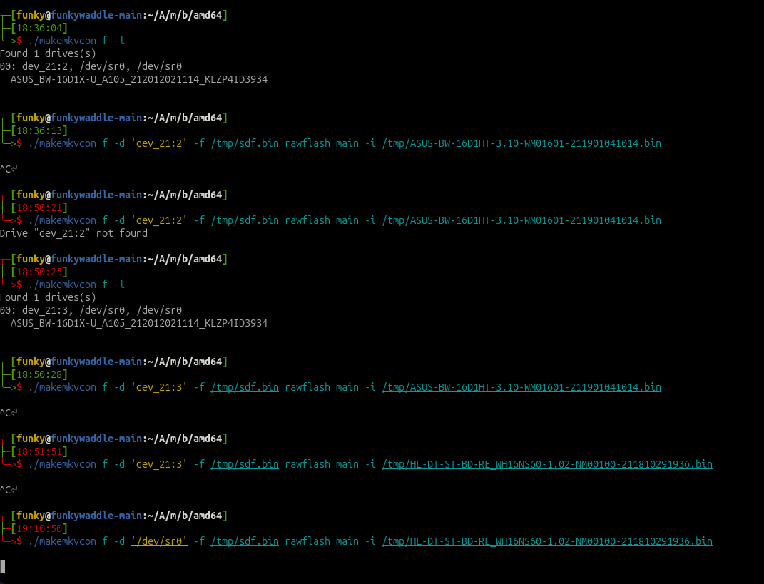

I'm having some issues trying to flash my drive.
OS device name: /dev/sr0
Manufacturer: ASUS
Product: BW-16D1X-U
Revision: A105
Serial number: KLZP4ID3934
Firmware date: 2120-12-02 11:14
Bus encryption flags: 1F
I am running on Ubuntu 25.10.
I downloaded the sdf.bin file, and downloaded the "The all you need firmware pack".
I first extracted the `ASUS-BW-16D1HT-3.10-WM01601-211901041014.bin` file, and copied both it and the sdf.bin file to /tmp, but as you can see from the image below, that didn't work. Then I extracted the `HL-DT-ST-BD-RE_WH16NS60-1.02-NM00100-211810291936.bin` file and put that into /tmp.
The command I ran:
./makemkvcon f -d 'dev_21:3' -f /tmp/sdf.bin rawflash main -i /tmp/HL-DT-ST-BD-RE_WH16NS60-1.02-NM00100-211810291936.bin
But to no avail. You can see from the image that it's not doing anything. I even waited for 20 minutes just in case it was a slow process. But no indication it's doing anything. No progress indicator, no output, no errors, nothing.
Any ideas, thoughts, help, guidance, etc would be greatly appreciated.

enc
funkywaddle
Joined: Thu Sep 24, 2026 11:55 pm
Re: Asus BW-16D1X-U
Post by funkywaddle »
Billycar11 wrote: Fri Sep 25, 2026 2:59 am
funkywaddle wrote: Fri Sep 25, 2026 12:36 am I'm having some issues trying to flash my drive.
Manufacturer: ASUS
Product: BW-16D1X-U
Revision: A105
The command I ran:
enc
enc, not main?
I did finally get it to work. I had to downgrade to 1.17.7. It seemed to work alright. I'm currently making a mkv from a bluray disc. We'll see if it works.
Should I have done enc instead of main? Do I need to do it again?
