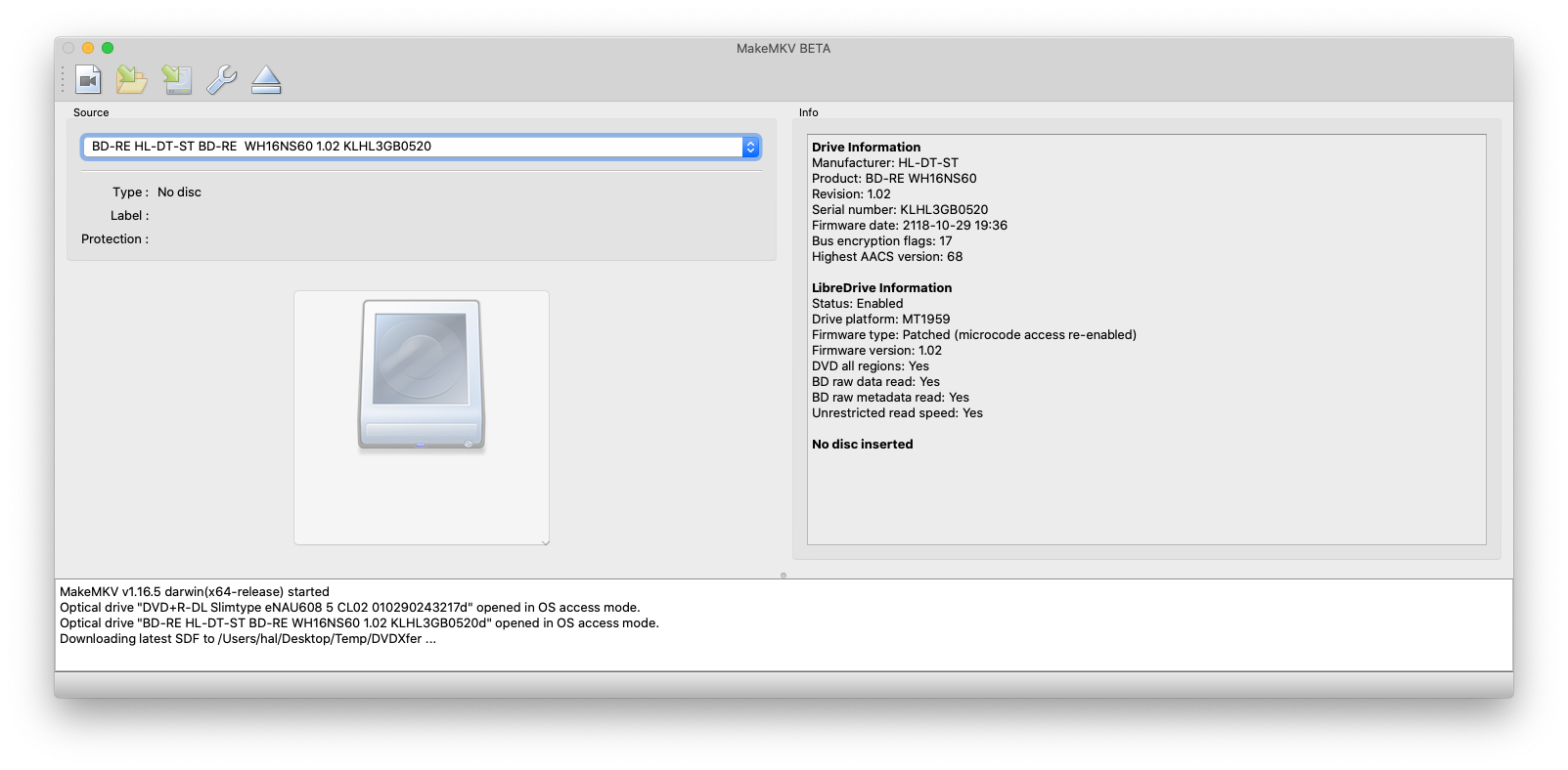

I followed the instructions:
Then I unplugged the drive and let it sit for a few minutes and reconnected it. I started up MakeMKV and got this:
So, apparently, even though I flashed it properly and it finished the job in the console, the drive did not get flashed. Also note this 2nd screen shot is after I also rebooted my iMac.
What do I need to do to fix this?

Now I get this. Yay! Thank you for the help!MartyMcNuts wrote: Sat Feb 26, 2022 10:17 amYour BH16NS58 1.03 is most likely encrypted, so in your command, simply change "main" to "enc" and the flash should work. I also suggest flashing to WH16NS60 1.02-MK from the MK firmware pack (in the old folder) as WH16NS60 1.03-MK is absolute garbage.Tango wrote: Sat Feb 26, 2022 9:27 am My drive flashed and supposedly was updated with LibreDrive - but it wasn't!
- Screen Shot 2022-02-27 at 5.03.32 PM.png (224.3 KiB) Viewed 23093 times

The May 2016 drive on MakeMKV shows up as:
Drive Information:
Product: BD-RE BP50NB40
Revision: 1.00
Serial number: XXXXXXXXXXX
Firmware date: 2115-04-22 15:17
Highest AACS version: 76
LibreDrive Information:
Firmware version: 1.00
& the March 2021 drive shows up on MakeMKV as:
Drive Information:
Revision: 1.03
Harware support: Yes
Firmware support: No
Firmware version: 1.03
It's the SVC code I'm worried about (NB40) as most of the guides state to have NB50 (I think?). Can any anyone confirm whether these will work for 4K before I try something that bricks my drive?
Thanks!![]()
The 2nd one can be done, for sure. Most of the BP50NB40's I have flashed are SVC: NB40.
For UHD campatibility, these need to be cross-flashed to either BP60NB10 or BU40N firmware as the BP50NB40 firmware is not UHD capable. If you don't want to do it yourself, you can get a single drive flasher from me which is very easy to use. See my signature for the link.
