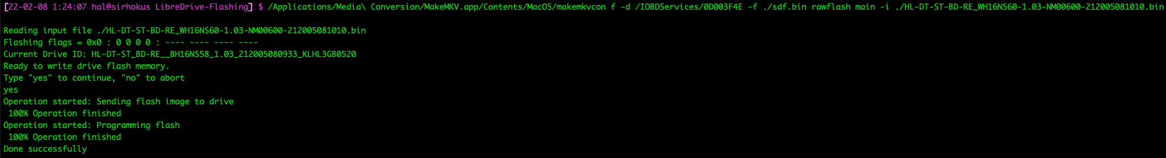

Post by Tango »
My drive flashed and supposedly was updated with LibreDrive - but it wasn't!
I followed the instructions:
Screen Shot 2022-02-08 at 1.49.53 AM.png (59.25 KiB) Viewed 22535 times

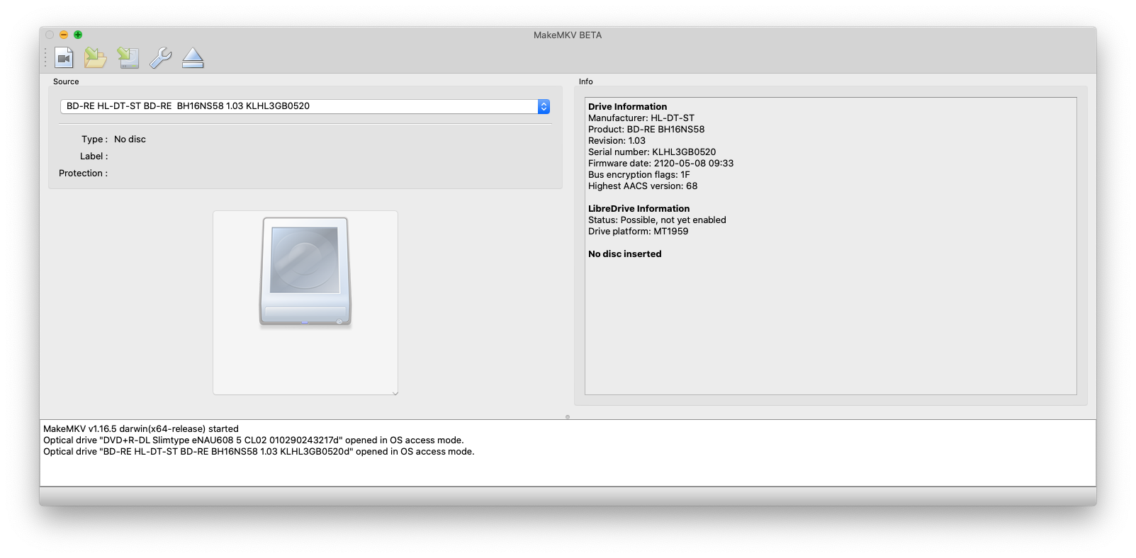

Then I unplugged the drive and let it sit for a few minutes and reconnected it. I started up MakeMKV and got this:
Screen Shot 2022-02-22 at 11.24.25 AM.png (205.17 KiB) Viewed 22535 times
So, apparently, even though I flashed it properly and it finished the job in the console, the drive did not get flashed. Also note this 2nd screen shot is after I also rebooted my iMac.
What do I need to do to fix this?
