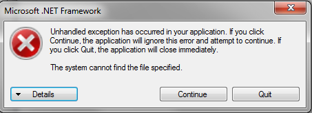

I am attempting to flash an LG WH16NS40 with 1.05 using the SDFtool flasher. When I run the .exe I get the following error:
If I hit continue, the flasher will open, but it will not recognize any drives. I have the LG hooked up via an external USB enclosure and have the latest .net framework. Any help would be very much appreciated!

rayians wrote: Sun Sep 27, 2020 2:51 pm I am attempting to flash an LG WH16NS40 with 1.05 using the SDFtool flasher. When I run the .exe I get the following error:
Do you have MakeMKV installed?
Do you have .net Framework 4.7.2 installed?

Very strange situation with my PC. I checked the .NET framework version using the cmd prompt and it shows up as 4.0.0. I tried to install 4.7.2 and it would not allow me to because it says I have 4.7.2 or later already installed.

rayians wrote: Mon Sep 28, 2020 4:31 pm Very strange situation with my PC. I checked the .NET framework version using the cmd prompt and it shows up as 4.0.0. I tried to install 4.7.2 and it would not allow me to because it says I have 4.7.2 or later already installed.
Not sure what to say here.....
You could try using the modified ASUS flasher, as long as your drive does not have an encrypted firmware on it.
