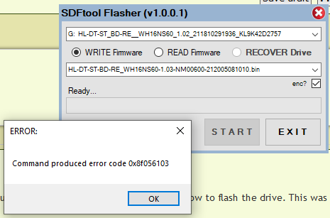

When trying to update my drive for the first time I am getting the error in the attached file. I can dump the firmware. I've tried with and without enc enabled.

Ok. Please don't flash your drive to NS60 1.03. if it came with 1.02 flash NS60 1.02 MK. 1.03 is not better in any way. Also, "enc" is not required since your drive did not come with encrypted firmware.melkore wrote: Wed Sep 09, 2020 3:06 am When trying to update my drive for the first time I am getting the error in the attached file. I can dump the firmware. I've tried with and without enc enabled.

That did it. I didn't know that the older firmware was in a different location than the latest. I only found 1.03 and figured that's what I needed. It is now flashed and currently ripping a 4k bluray. Thanks!MartyMcNuts wrote: Wed Sep 09, 2020 1:23 pm

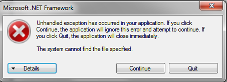

I'm getting a .NET error when I launch the program on two different Windows 10 machines that I have tried. Any idea what I can do? I've tried the simple Googled fixes but with no joy.
Very frustrating!

Ensure that MakeMKV is installed and that you have the latest version of the .net framework installed.CIR Engineering wrote: Mon Sep 14, 2020 8:42 pm I'm getting a .NET error when I launch the program on two different Windows 10 machines that I have tried. Any idea what I can do? I've tried the simple Googled fixes but with no joy.

Thanks. Trouble is you never know which version of .NET framework may be out of date, Microsoft just has too many variants and no easy way to tell if they are all up to date. They really need to unify that a bit better.
In any event I got it working. Of all the crazy things, I plugged the drives into my NexStar DX NST-53053 USB enclosure and connected it to my Windows 10 VM running as guest on unRAID Slackware and it f---ing worked that way. This was the most construed approach and I thought the chance of it working were close to zero, but there it is.
In any event, I made four WH14NS40 1.05's into four Asus BW-16D1HT 3.10's. They now rip UHD great.
Thanks for the new tool!
