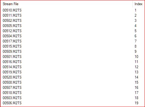

..and another RB version. All my my M2TS begin with 510 and end with 506. Looks like Lion G just re numbered the M2TS streams for different playlist.

and for BDinfo fans:
sneaky no?

LG-BDNU40 wrote: Thu Sep 12, 2019 4:44 pm
sneaky no?
Can you please show the Playlist File section? Thanks.

hvnphoto wrote: Thu Sep 12, 2019 5:02 pm
sneaky no?
Yes, BDinfo chose this:
Title information
Name: John Wick 3: Parabellum (English)
Source file name: 00298.mpls
Duration: 2:10:45
Chapters count: 16
Segment count: 19
Segment map: 510,511,502,505,512,515,514,504,516,509,519,503,508,507,517,501,520,518,506
File name: John Wick 3- Parabellum_t134.mkv
I originally posted wrong BDinfo segments for 298.mpls
After time to view, both the main and BDinfo versions wacked with out of place segments. Sorry to waste anyone's time...
