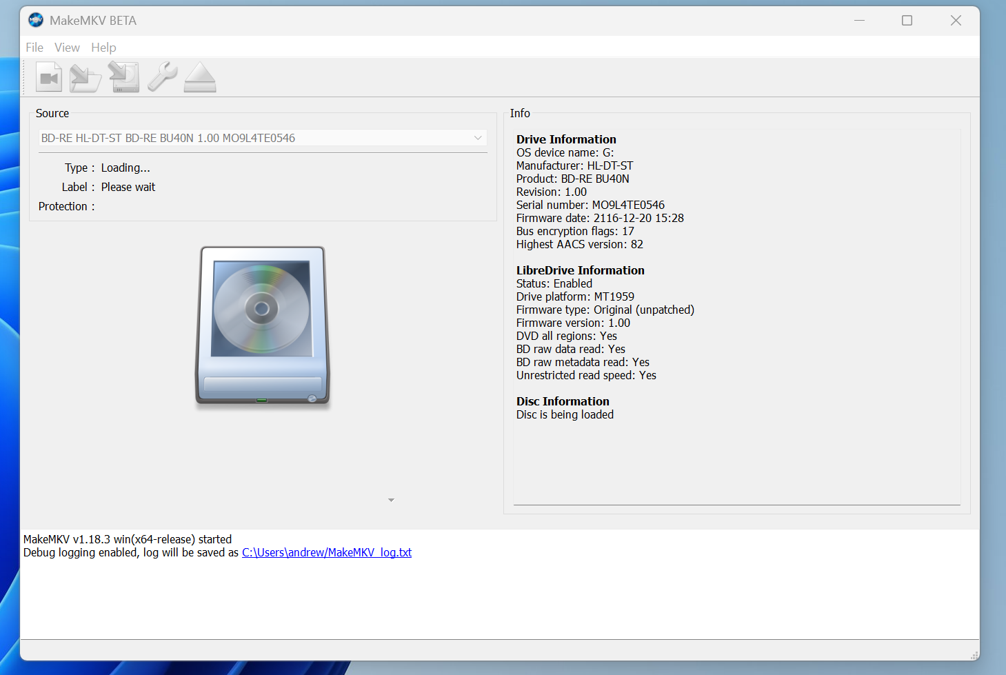

Open mkv, put a disc in (any of the drives) and MakeMKV see the disc and tries to start to open it, but it just gets stuck on loading. The lights on the disctray stop right away. I never get to the point where i can click to have MakeMKV load the tracks.
it says like this for 45 minutes:
