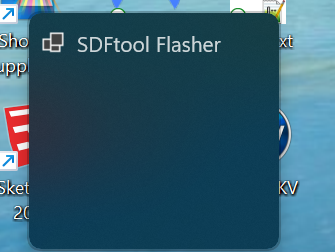

sgibbers17
- Posts: 14
- Joined: Wed May 29, 2013 12:41 pm
Re: SDFtool Flasher
I just downloaded the tool but does not show up correctly on my windows 11 machine. It appears that the windows is too small and I can not see the check marks and the text is cutoff. Windows will not let me make the window bigger.

Re: SDFtool Flasher
that didn't work the app will not even show up.MartyMcNuts wrote: Wed Mar 18, 2026 10:48 pmFrom the first post.sgibbers17 wrote: Wed Mar 18, 2026 10:39 pm I just downloaded the tool but does not show up correctly on my windows 11 machine. It appears that the windows is too small and I can not see the check marks and the text is cutoff. Windows will not let me make the window bigger.
NOTE: If the GUI looks a bit deformed (happens on a 4k monitor), you can right click the exe and select properties. In the compatibility tab, click "Change high DPI settings" then under "High DPI scaling override" tick the box and select "System (Enhanced)" in the dropbox.

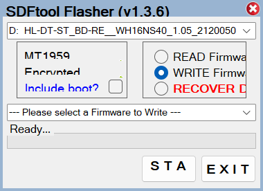

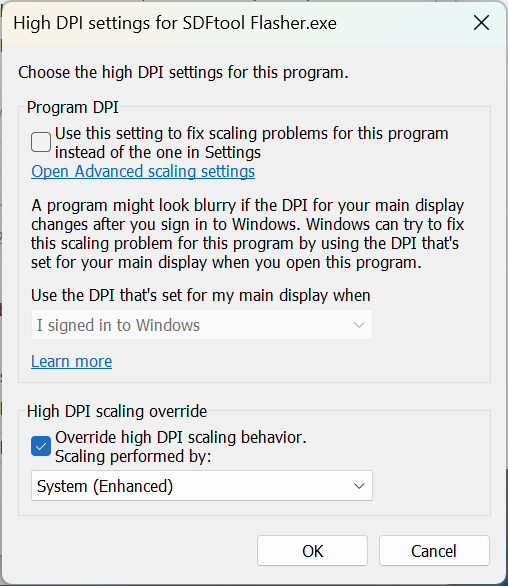

sgibbers17
- Posts: 14
Re: SDFtool Flasher
This is a screenshot of before settings are changed. Screenshot of my settings what it looks like with the new settings.MartyMcNuts wrote: Wed Mar 18, 2026 10:58 pmWhat?!?sgibbers17 wrote: Wed Mar 18, 2026 10:56 pmthat didn't work the app will not even show up.MartyMcNuts wrote: Wed Mar 18, 2026 10:48 pm
