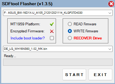

Hi all,
After doing some investigation on Reddit in regards to flashing a 4K firmware onto my ASUS BW-16D1-XU drive, a user said I could use a firmware for what seems to be an LG drive (DE_LG_WH16NS60_1.02_MK) and it worked for that user. Trying to flash it onto my drive and it spits out an error, screenshots attached. I'm super new to this so any advice would be greatly appreciated!
- Posts: 5096
Re: SDFtool Flasher
Take the disc out of the drive!epicchancellor wrote: Tue Mar 10, 2026 1:37 am Hi all,

epicchancellor
- Posts: 12
- Joined: Tue Mar 10, 2026 1:25 am
Re: SDFtool Flasher
Thank you for that! I didn’t think there was a disk in there but the flash did work! I tried putting in Ballerina and it still didn’t recognize the media. I didn’t have the chance to try another disk before I had to head out so is it a chance the media is just too new or something?MartyMcNuts wrote: Wed Mar 11, 2026 3:52 amTake the disc out of the drive!epicchancellor wrote: Tue Mar 10, 2026 1:37 am Hi all,
