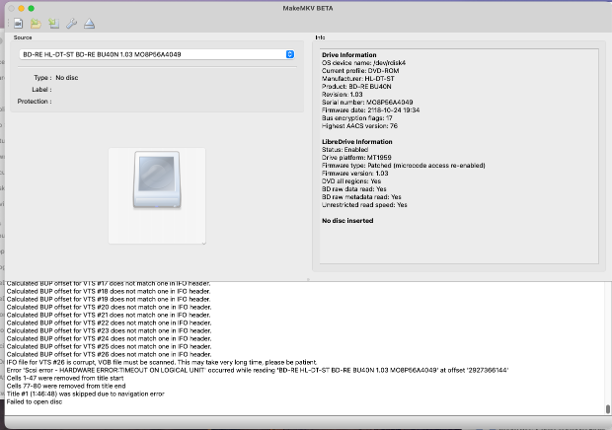

Hey all... this is my first time around in attempting to rip 4K Blu-ray's and I have purchased a verbatim 43888 for my 2024 MacBook Pro with macOS 26. I've done my best to follow all the instructions and will always essentially where I've landed and seems like it has stalled out. Any hints or chips that can be offered would be greatly appreciated.
Re: Struggling to open UHD discs on BU40N
The drive's firmware is probably encrypted. You need to switch 'rawflash main' to 'rawflash enc'.mocha1970 wrote: Sun Nov 30, 2025 12:21 am Hey all... this is my first time around in attempting to rip 4K Blu-ray's and I have purchased a verbatim 43888 for my 2024 MacBook Pro with macOS 26. I've done my best to follow all the instructions and will always essentially where I've landed and seems like it has stalled out. Any hints or chips that can be offered would be greatly appreciated.

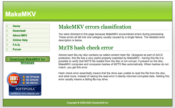

All,
Thanks for the responses as they helped me get much further along is the process. As you can see the drive was successfully patched but now I am receiving errors. See below
Any support would be greatly appreciated. I'm really hoping it's not a hardware issue as this drive is barely a week old.
