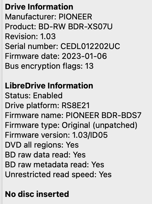

Good evening,
Here are the credentials of my drive. This Is the first time it has shown status Enabled for LibreDrive since I owned it and it was one of the dreadful firmware 1.03 which wasn't supported initially. As this is a UHD "capable" drive, Do I still need to flash it to rip UHD? I have a Mac by the way, and don't have access to windows. Thank you in advance!
Manufacturer: PIONEER
Product: BD-RW BDR-XS07U
Revision: 1.03
Serial number: CEDL012202UC
Firmware date: 2023-01-06
Bus encryption flags: 13
Drive platform: RS8E21
Firmware version: 1.03/ID05
