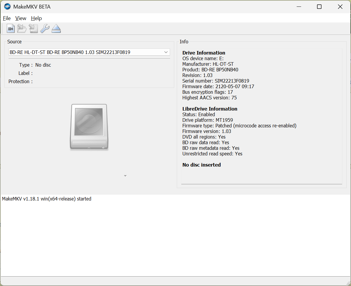

stateWideBread
- Joined: Mon Apr 28, 2025 4:57 am
Re: SDFtool Flasher
Hi MartyMcNuts,
I have a LG slim portable drive BP50NB40 SVC NB52 drive and I was able to use your tool and follow your 4 step instructions with the tool all reporting success. However, when I inserted a UHD disc into the drive it failed to recognize the disc with MakeMKV 1.81.1 and have this repeated spin up and then stop sound.
I tried resetting the PC and also un-attaching and re-attaching the drive, but still get the same result. Attached is a screen shot of my drive info in the MakeMKV. I am wondering can you provide some guidance?
- 2025-04-27.png (60.12 KiB) Viewed 33911 times
- Posts: 5054
Re: SDFtool Flasher
Umm.... You haven't completed the process. You have only done half as your drive is still on BP50NB40 1.03 MK firmware. You need to perform the reovery steps now to get the drive cross-flashed. Follow the gif!!stateWideBread wrote: Mon Apr 28, 2025 5:08 am Hi MartyMcNuts,

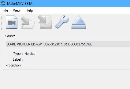

KAIJUKACZ25
- Posts: 22
- Joined: Sun Apr 27, 2025 12:08 am
Re: SDFtool Flasher
I didn't know if this was necessary, but, here it is anyway..
Thanks for helping me MM!
Krazy Kacz
- Make MKV info 4 MM - Copy.jpg (13.32 KiB) Viewed 33554 times
