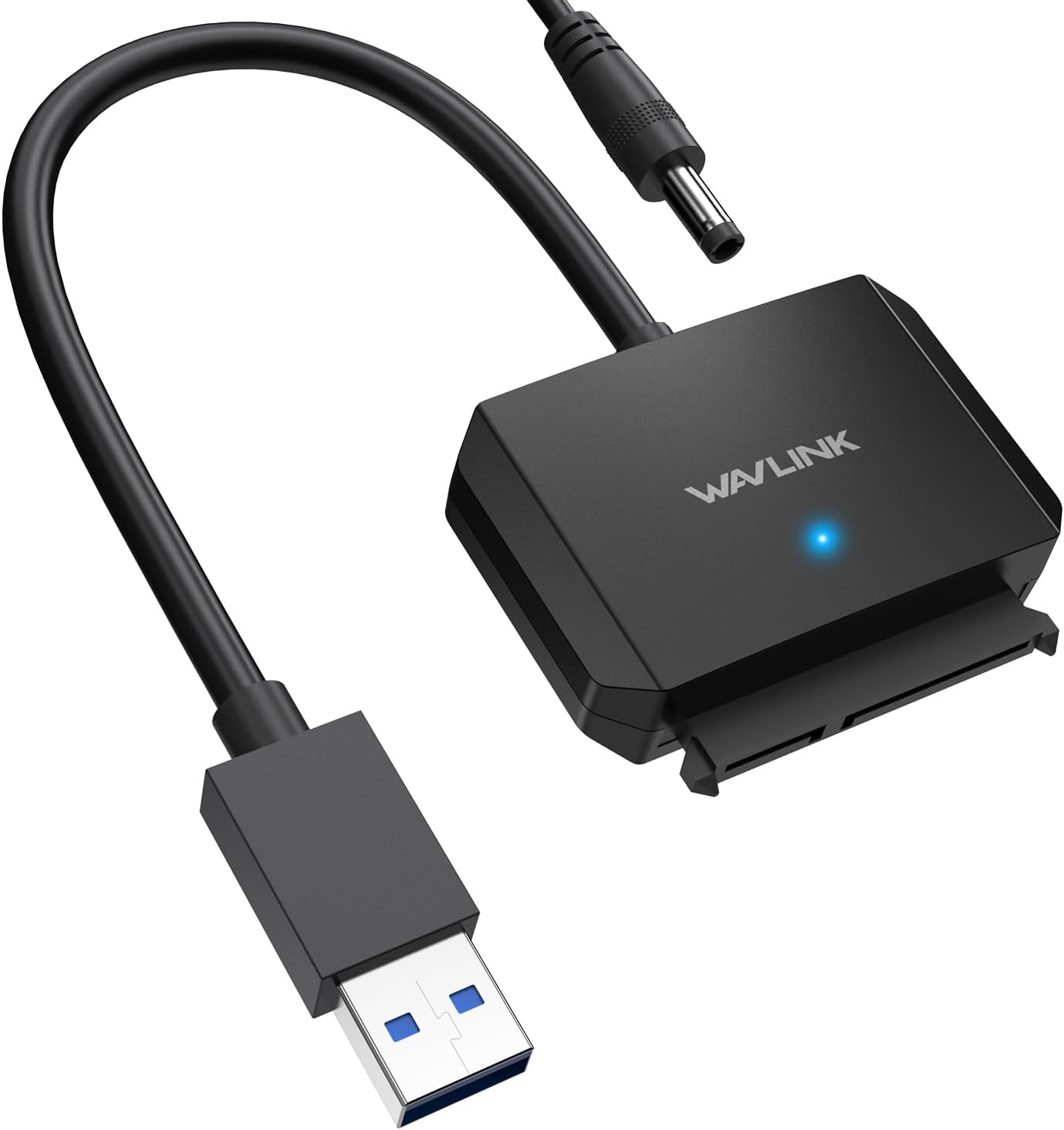

Hello.fishman wrote: Sat Jun 01, 2019 4:23 am I just tried one of each of these sata-usb adapters and neither worked for flashing, which was strange because it was (visually) the one Marty said he had, but the part number IS different.
https://www.amazon.com/gp/product/B00VR52ZZ0
https://www.amazon.com/gp/product/B00CK205ZG
Shall I send them back stating they don't support optical drives?
Does this USB adapter also work for firmware flash?
Inateck USB 3.0 to SATA converter adapter for 2.5/3.5 inches drive HDD SSD
Specifications: Output Interface: USB 3.0/2.0 Power Input: 100-240V, 50/60Hz; Output: DC 12 V/2 A HDD Compatibility: All 2.5"/3.5" SATA HDDs Connection of Bluray, DVD, CD drives, DVD-ROM, CD-RW, DVD-RW, DVD+RW possible
https://www.ebay.de/itm/175131704887?_s ... 2256179279
- Posts: 4842
Re: Ultimate UHD Drives Guide Updated 2019
Not sure. I'm sure this works even for flashing. So spend a few Euros more.Phoenix0870 wrote: Mon Sep 30, 2024 8:58 pmHello.fishman wrote: Sat Jun 01, 2019 4:23 am I just tried one of each of these sata-usb adapters and neither worked for flashing, which was strange because it was (visually) the one Marty said he had, but the part number IS different.
