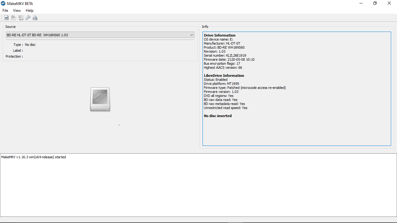

I have version 1.03 MK Pach installed.
Drive Info as Shown in MakeMKV.png (38.75 KiB) Viewed 12480 times

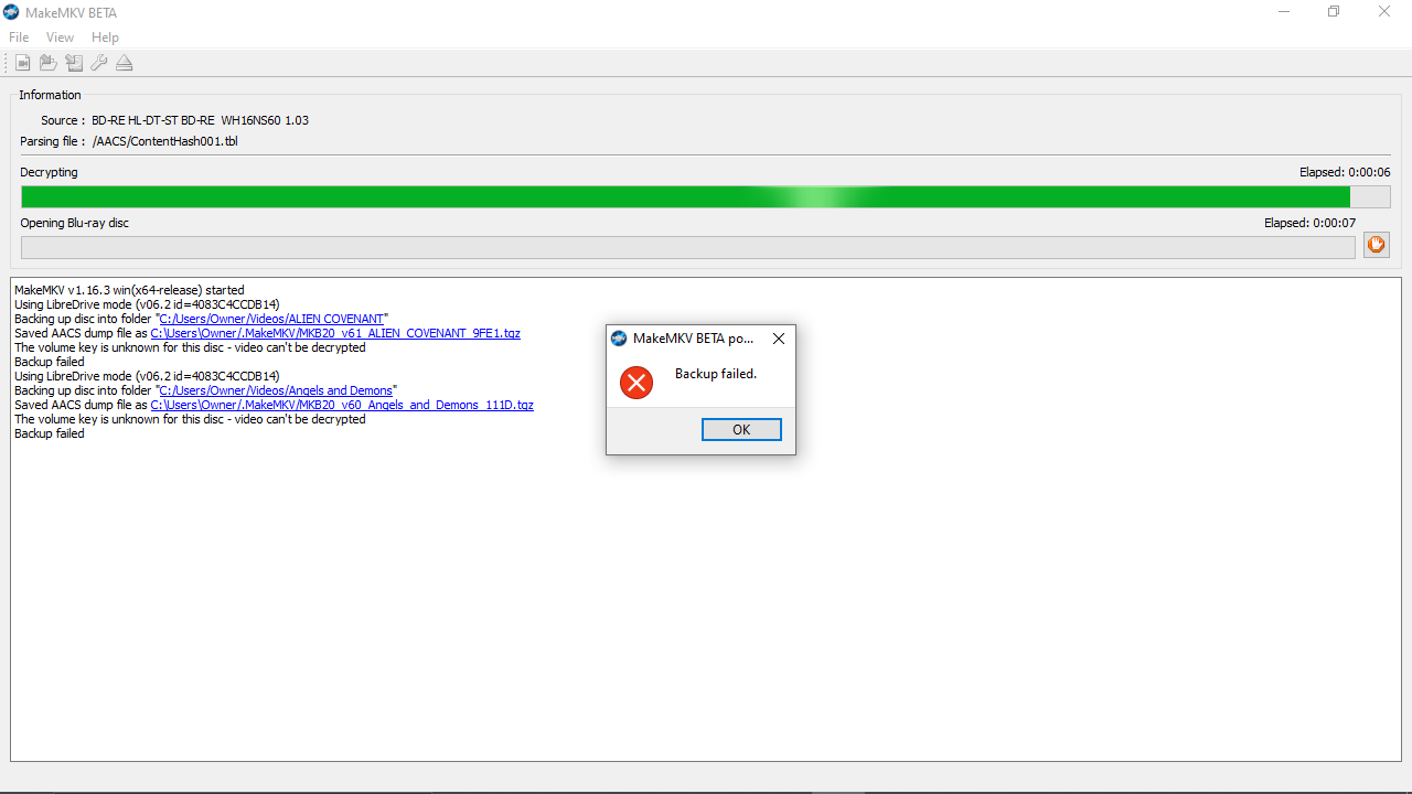

After clicking File>Backup, choosing my destination, and clicking OK, I got this error on four 4K UHD Blu-rays in a row--😲!
Error when Using MakeMKV's Backup Feature with the LG WH16NS60 1.03 MK Pached.png
Error when Using MakeMKV's Backup Feature with the LG WH16NS60 1.03 MK Pached.png (47.17 KiB) Viewed 12480 times
I thought the LG WH16NS60 was compatible with MakeMKV even though it's a UHD official drive.

a few ideas make sure your makemkv data directory is accessible and contacting webserver for update is allowed in the makemkv settings.
if all that checks out i can give you my privatedata.tar to see if that will fix your issue that has the keys in it

1st of all, text in the MakeMKV Info (right) & Output (bottom) panes is selectable & is much easier to copy/paste/quote/review than images (IMO).
Each sub-forum offers FAQs/pinned posts addressing most common issues & is the best place to start when encountering an issue. In your case, this one in UHD discs jumps out...
Fixing Volume Key is Unknown
Hope this helps.

I'm not a fan of automatic software updates. So I did have the "Online Update/Updates" checkbox unchecked. So I checked it, and after a few tries, it worked. Then I went into the Windows Registry Editor and in the empty MakeMKV read speed string, I maxed it out and filled it in with a string of 0=99. I was able to rip a tripple-layer, 80GB 4K UHD Blu-ray between 40 and 45 minutes, and a dual-layer 45GB HD Blu-ray within about 20 minutes. When I did that with my WH16NS40 with its respective 1.05 MK patch installed, it kept spinning, but for some reason, it wasn't reading, but got stuck spinning at a high speed, and I had to turn it off to snap it out of that wierd status. This is a good sign of how tough the WH16NS60 just might be. During the next few days, I plan on going through the 40 discs in my 4K UHD Blu-ray collection to determine my WH16NS60's stability.
If any discs give me problems, I'll delete that speed string from the Windows Registry Editor and try such discs at the default speed. Thanks, guys. See you in a few days.
