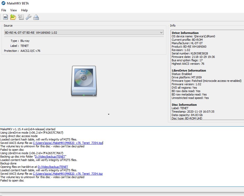

I bought TENET 4K UHD and I'm unable to open the disc. I've tried the normal way from the MakeMKV app and via the Backup method and neither approach worked.
Screenshot:![Image]()
I've emailed the dump file.
Any suggestions?
Screenshot:
Any suggestions?

Per the stickied FAQ, now that you’ve submitted the dump file, wait for the hashed key to be updated for the particular disc you have.JulesKeeper wrote: Fri Jan 29, 2021 11:31 pmI've tried the normal way from the MakeMKV app and via the Backup method...
Any suggestions?
In the meantime, if you want to, you should be able to make a backup without decrypting the video, which allows you to sort out any potential disc cleaning issues and once the key is available, you can open the backup rather than the disc.

Working now! Thank you to whoever made the Hashkey available.preserve wrote: Sat Jan 30, 2021 4:07 amPer the stickied FAQ, now that you’ve submitted the dump file, wait for the hashed key to be updated for the particular disc you have.JulesKeeper wrote: Fri Jan 29, 2021 11:31 pmI've tried the normal way from the MakeMKV app and via the Backup method...

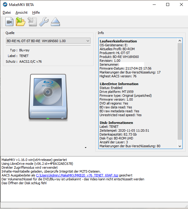

I have the same problem with the disc. Can someone here help me with this?

You need to email the dump file that was generated to svq@makemkv.com. UHD FAQ: https://www.makemkv.com/forum/viewtopic ... 12&t=16883RobertHQ wrote: Wed Mar 03, 2021 9:23 pm I have the same problem with the disc. Can someone here help me with this?

Thanks, I did that, but unfortunately I haven't received any feedback yet.

Nor will you. If you're expecting some kind of response, you're not going to get one. The key will be added whenever Mike gets to it and at that point it'll just start working assuming MakeMKV is set to automatically update the key database.

WOW Now I can key my disk thanks for the tip with the upload and the MakeMKV online the key contacts.
