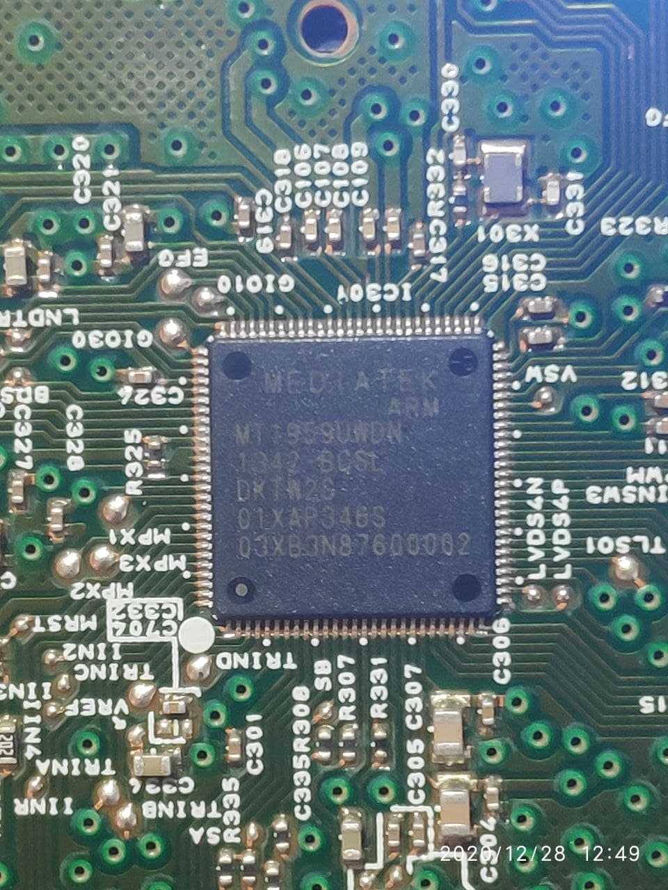

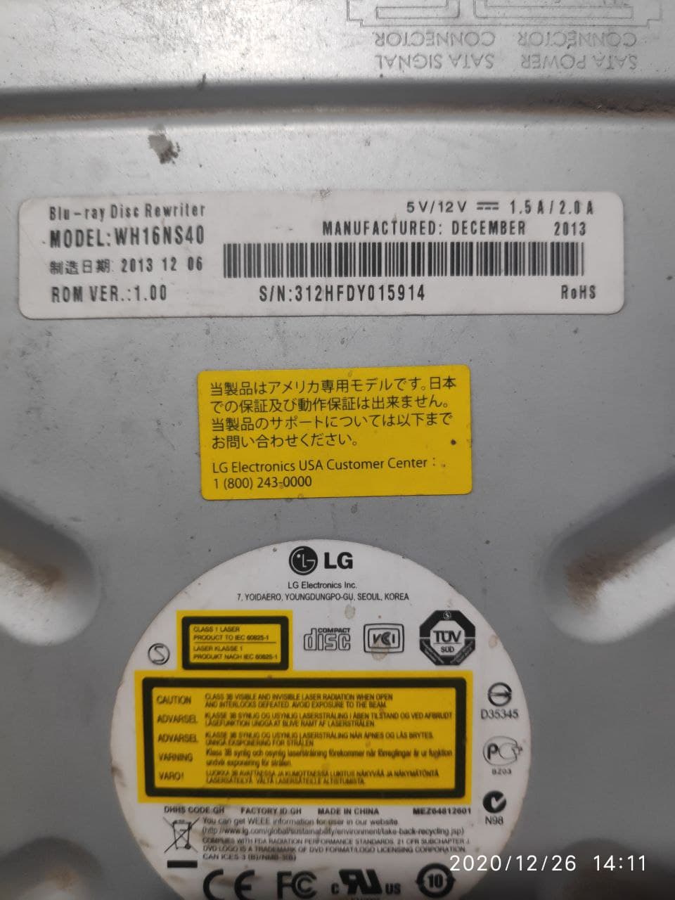

Looks like am in a similar situation.
Background: I have this wh16ns40 drive brought somewhere in 2014/15 and its manufactured in Dec 2013.
I use primarily this to burn data blu rays and it gave an error kind of which says "power calibration error" and stops, no intent to rip anything. This prompted me to upgrade the firmware of this drive as it was 1.00 version with a view that it will probably add support for more bluray media.
I downloaded 1.05 from LG site and tried flashing it. It progressed and my system hanged in the process and became unresponsive which i had to reset. This rendered the drive to stop showing up any disk i throw at it and stopped spinning, no light. I can only eject tray out.
I read through experiences of others thru this drive model and there is no explicit mark of SVC-NS50 however I remember seeing SVC-NS50 shown both places when i tried to upgrade to 1.05 on the official flasher. The board does have mt1359 chip.
I tried using dosflash with an official version by using eeprom data mover but no luck so far.
Any suggestion from anyone on what i can do? ofcourse throwing it into wc is one of the option
but any thoughts around rescue would be great.
Thanks for reading.
Thanks for reading.

I really appreciate you attempting to get a follow-up on this issue. The drive is still here brick and waiting to be fixedMartyMcNuts wrote: Sat Dec 12, 2020 11:53 pm@mike admin,sorntor wrote: Tue Dec 08, 2020 1:28 amMartyMcNuts wrote: Tue Dec 08, 2020 12:01 am
I was hoping that would work for you. Bugger....

quick update.
After reading the threads fully and various drive models concerning wh16ns40, i understand my drive is mt1939 type and cant take anything that made for mt1959.
Luckily, i didnt loose the critical data thats unique to drive and i picked up an image thats meant for mt1939 (BH16NS40) and modded with the caliberation data at hex address 01e8000 and 01e9000.
My drive back to life and it can now read all discs and write CDs/DVDs but could not successfully burn BD data discs. Could be meadia issue or this firmware thing not fully fixed.
Anyone has WH16NS40 1.00 clean version for mt1939, appreciate if i can get that image to try.
Thanks for reading.
Thanks for reading.

First post of the SDFtool Flasher thread has the WH16NS40 1.01 clean firmware for your drive.rbalu72 wrote: Sun Jan 17, 2021 6:25 am quick update.

Pretty sure that didn't do the trick for me. But we were able to confirm it wasn't actually flashing.MartyMcNuts wrote: Sun Jan 17, 2021 7:34 amFirst post of the SDFtool Flasher thread has the WH16NS40 1.01 clean firmware for your drive.rbalu72 wrote: Sun Jan 17, 2021 6:25 am quick update.
Thanks for reading.
