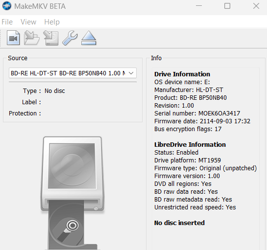

Hi there - wonder if anyone can assist me. I have a Archgon MD8107U3 drive that someone has given me which now does not work. It's a basically looks like it is bricked, the last thing they did with it was using the F/W windows tool and flashed it to See the makemkv screen shot shot. So, the drive now will pick up, but you cannot eject or effectively get it to respond. Any tips on how I get this if possible back working.
Interestingly when I try and reflash it via cmd line (I have nothing to lose as this was effectivley given to me as E-Waste) I get this
Reading input file D:\BLURAY\mk-firmware-pack-20200720\FW\MK\old\HL-DT-ST-BD-RE_BU40N-U101-MM01201-211711301153.bin
Drive tray is open, please close it and try again
DEBUG: Code 4278567171 at wfCw3OE9o6xoDD[;$ZOJdpeNgiQob2>_:29396644
Command produced error code 0xff05c103
Regardless of what ever firmware I try. Is this E-Waste or can it be salvaged?
Many Thanks.

- Bluray information.png (49.87 KiB) Viewed 19426 times
- Posts: 5820
Try with no encGrayman2024 wrote: Thu Sep 26, 2024 11:06 am Hi there - wonder if anyone can assist me. I have a Archgon MD8107U3 drive that someone has given me which now does not work. It's a basically looks like it is bricked, the last thing they did with it was using the F/W windows tool and flashed it to See the makemkv screen shot shot. So, the drive now will pick up, but you cannot eject or effectively get it to respond. Any tips on how I get this if possible back working.
Many Thanks.
Grayman2024
- Posts: 2
- Joined: Thu Sep 26, 2024 10:34 am
Sorry but had the same result. So I assume this is bricked.
