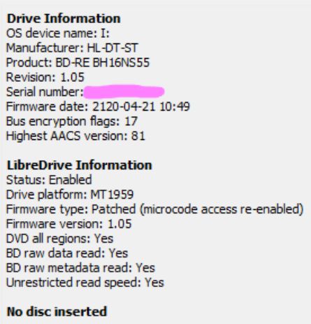

I just got my BH16NS55 in...
OS device name: E:
Product: BD-RE BH16NS55
Revision: 1.05
Serial number: [redacted]
Firmware date: 2120-06-18 13:42
Flasher tools don't seem to work at all. Any help would be appreciated.
zittrig
Posts: 338
Re: SDFtool Flasher
Post by zittrig »
Which firmware you want flash?
Posts: 1715
Re: SDFtool Flasher
Post by d00zah »
daemon9 wrote:
Tue Dec 17, 2024 1:57 pm
OS device name: E:
Revision: 1.05
The guide says"
BH16NS55 on any Firmware directly to > WH16NS60 1.02MK
Revision: 1.05 FW is encrypted, so make sure 'Enc' is checked. No disc in tray. Tray closed.
