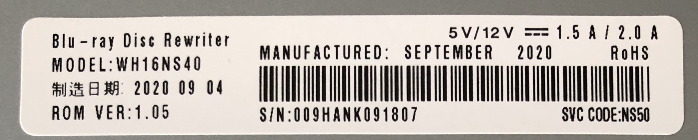

Hi, this is the image from the top of the drive
Posts: 5676
Re: SDFtool Flasher
Beans wrote:
Thu Jan 21, 2021 9:41 am
Strange should have worked this is why I recommend the one step flash process not 2 steps like you did less chance of something going wrong should have flashed directly to WH16NS60 1.02mk just return it and get another.
Looks beat up for a new drive anyway on the sticker

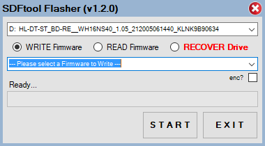

I've now tried updating with the official firmware update from the LG website, but I get this message.
Should I use SDFtool to flash with one of the old files, such as
mk-firmware-pack-20200720\MK\old\HL-DT-ST-BD-RE_WH14NS40-NS50-1.03-NM00600-211711211658.bin ??
Posts: 5676
Re: SDFtool Flasher
Beans wrote:
Thu Jan 21, 2021 4:51 pm
Don't even worry about it they don't check
