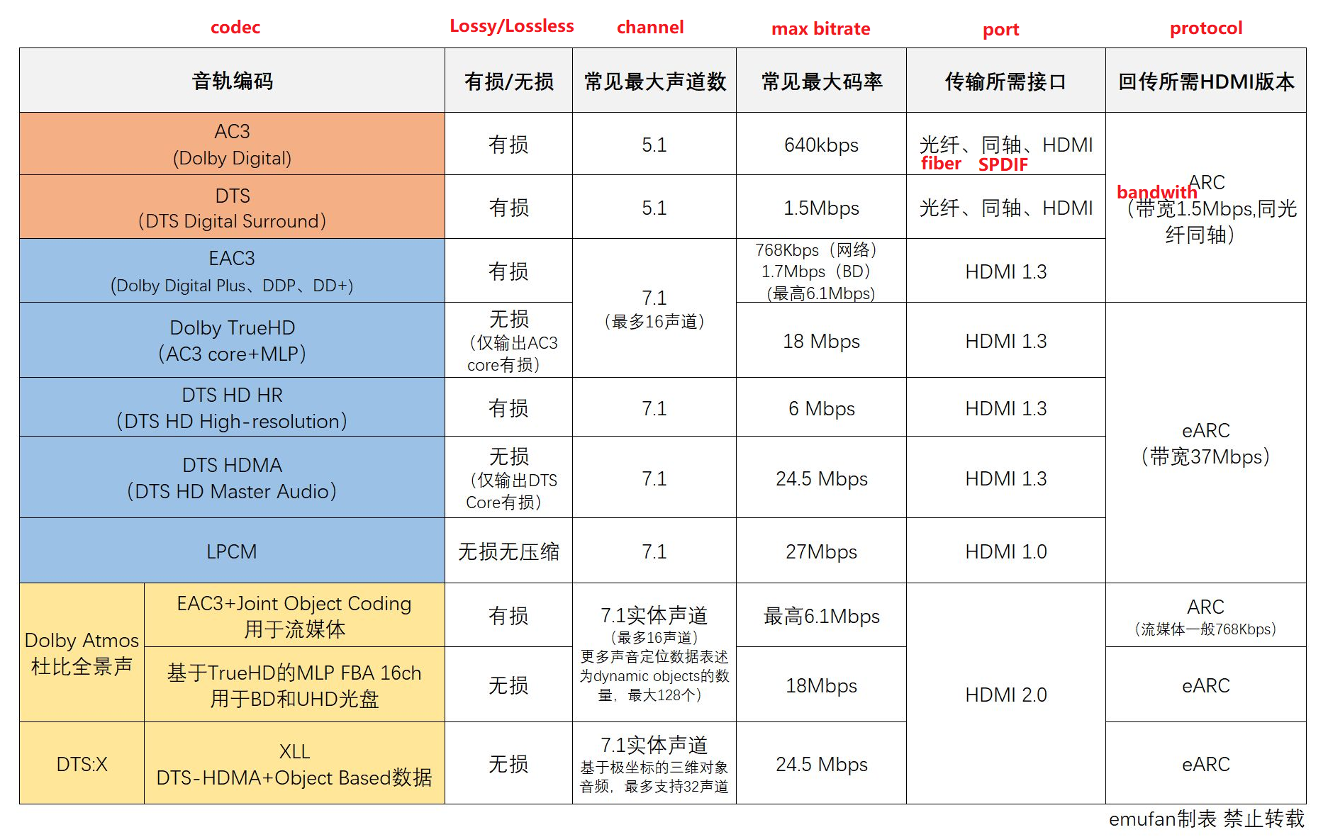

eac3 can have a core? I don't know that, I thought only TrueHD should have a core.
sw5163 wrote:
Fri Jul 22, 2022 12:48 pm
yes, a core is mandatory on bluray disc for EAC3.
i made a demo with a couple different audio you can test (i messed up the last part of the demo though):
https://drive.google.com/file/d/1D0qlUm ... sp=sharing
Audio #1
Format                                   : MLP FBA AC-3 16-ch
Muxing mode                              : Stream extension
Codec ID                                 : 131
Duration                                 : 6 min 28 s
Maximum bit rate                         : 5 064 kb/s
Stream size                              : 29.6 MiB (2%)
Number of dynamic objects                : 15
Audio #2
Format                                   : MLP FBA
Format/Info                              : Meridian Lossless Packing FBA
Commercial name                          : Dolby TrueHD
Codec ID                                 : 131
Maximum bit rate                         : 5 340 kb/s
Audio #3
Format                                   : E-AC-3
Format/Info                              : Enhanced AC-3
Commercial name                          : Dolby Digital Plus
Format profile                           : Blu-ray Disc
Format settings                          : Dolby Surround EX
Codec ID                                 : 132
Bit rate                                 : 1 536 kb/s
Stream size                              : 71.0 MiB (5%)
Audio #4
Format                                   : E-AC-3
Codec ID                                 : 132
Bit rate                                 : 768 kb/s
Stream size                              : 35.5 MiB (2%)
Audio #5
Format                                   : E-AC-3
Codec ID                                 : 132
Frame rate                               : 62.500 FPS (768 SPF)
