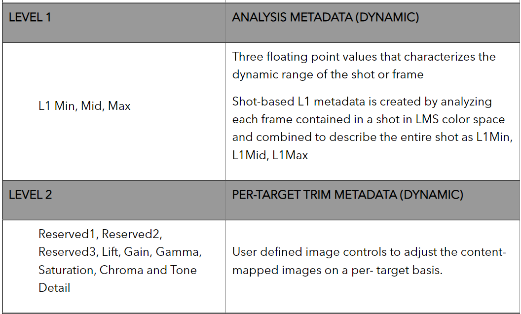

sw5163 wrote: Fri Jul 22, 2022 2:31 am So if L1 is not used, it will be HDR10 without tone mapping(clipped).
Please correct me if I'm wrong.
pretty much but the L2 still has an effect when present.
But the thing is that a lot of movies only have a 600nits trim( no effect on bright TV) and some others don't have any (rare).
In that case that's basically static DV. Not to mention all the HDR10plus conversions to DV.
