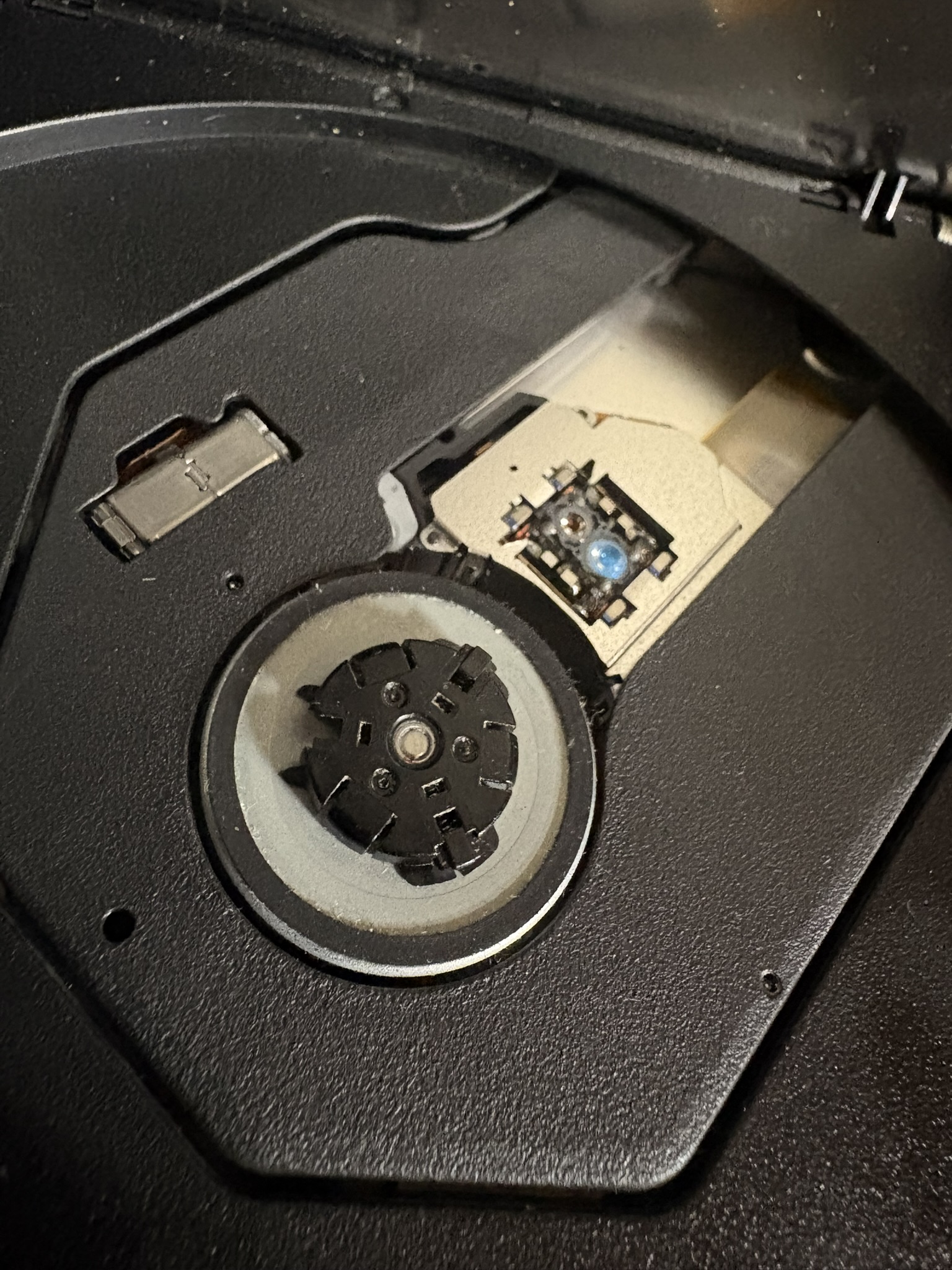

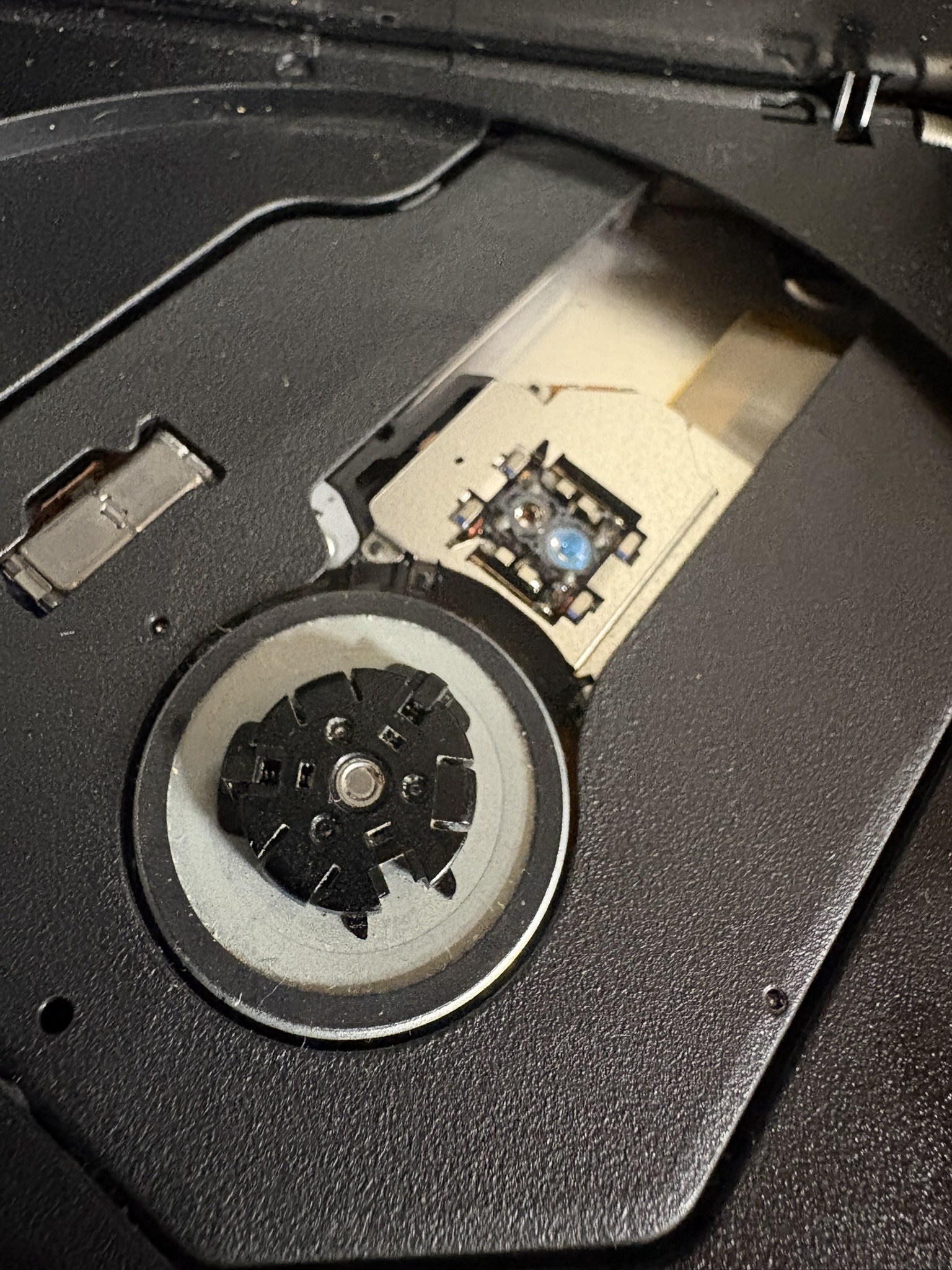

Hi, here are some photos of the spindle:
https://blacklight.fi/~zordiack/IMG_3723.JPEG
https://blacklight.fi/~zordiack/IMG_3724.JPEG
https://blacklight.fi/~zordiack/IMG_3725.JPEG
I did open the drive already to see if it is possible to exchange the spindle/motor, but the plastic black part is I think glued to the motor itself (the metal round cylinder part). The motor is part of drive assembly board, which has at least one soldered connection which I am not that eager to try to replace, also I could not find the spare part anywhere.
Maybe the only feasible option would be to carefully break the black part away from top and glue a replacement in place. I would be interested in trying to replace the spindle if it fits and paying for the spare.

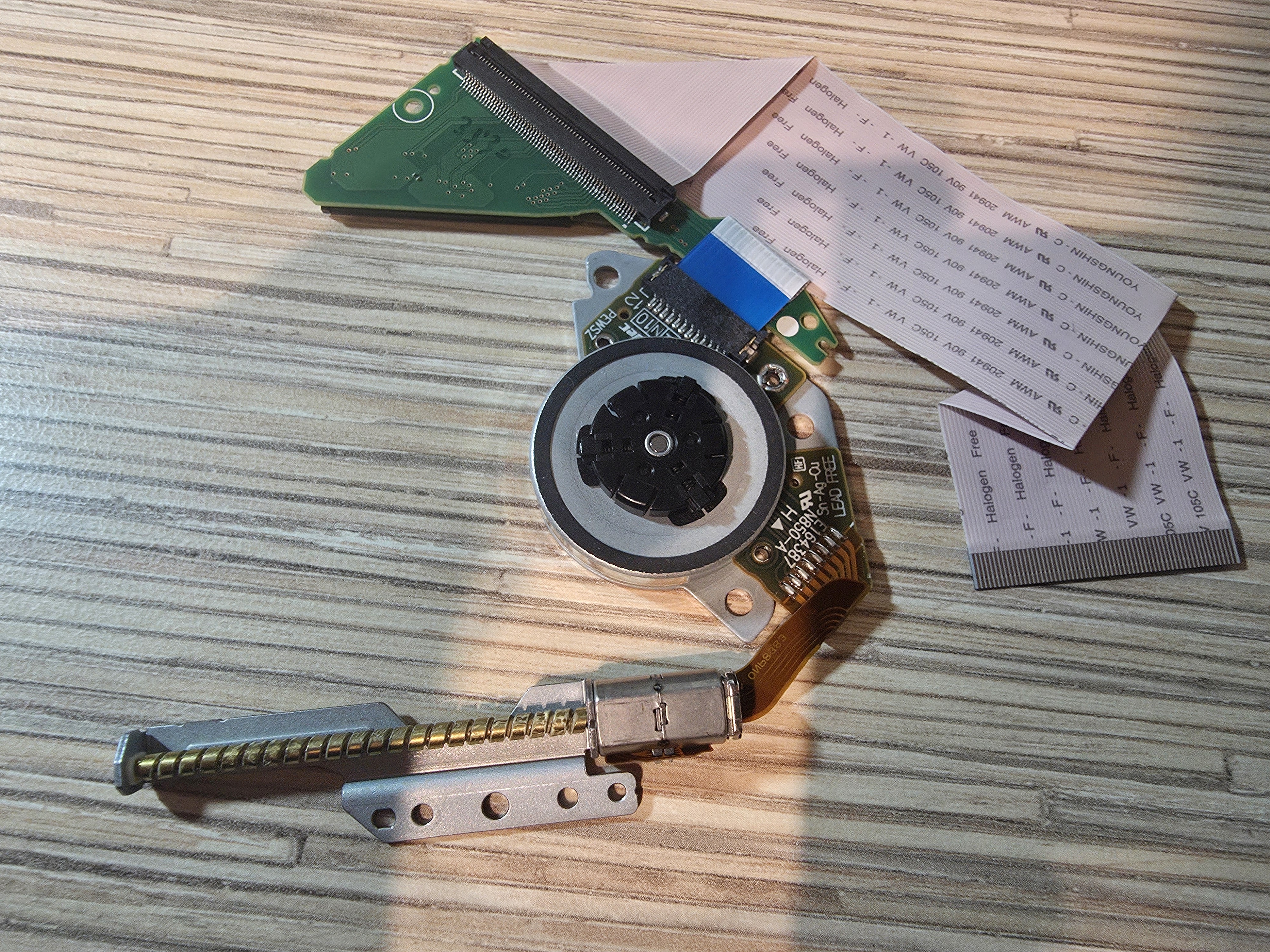

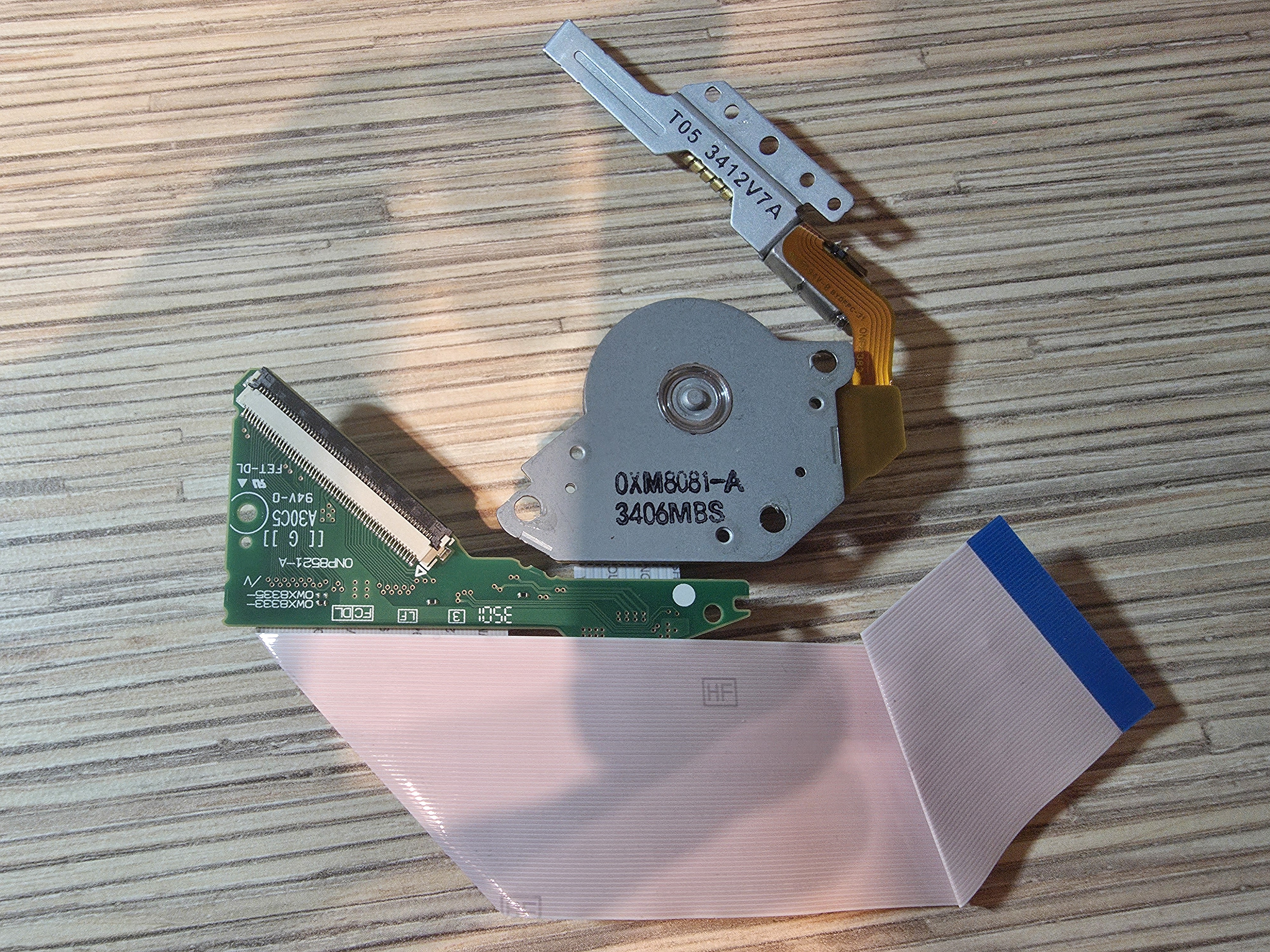

Hello, I removed the spindle motor from the drive. You can find the photos below. If the markings are similar or identical, then the part will most likely be compatible with the BDR-XD07.
https://i.postimg.cc/tyBy6K7s/spindle-motor-1.jpg
https://i.postimg.cc/Skj4fgzg/spindle-motor-2.jpg

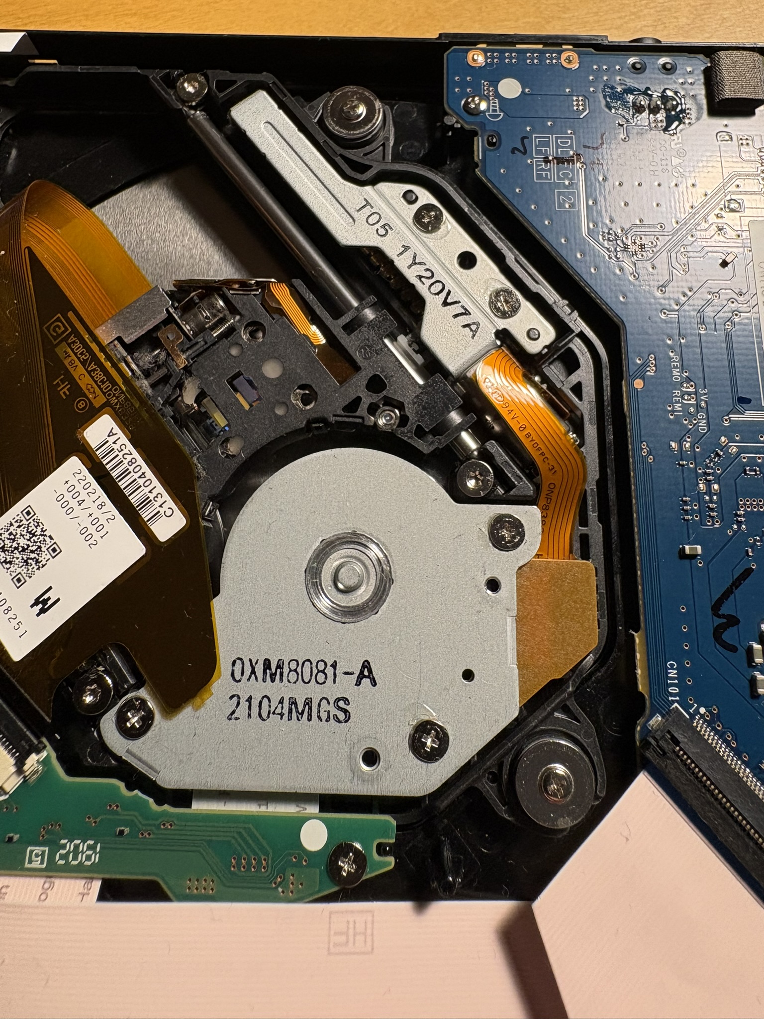

Hi, well the part does look similar, but the part numbers are not identical:
https://blacklight.fi/~zordiack/IMG_3718.JPEG
I'm not sure would it work, physically the motor and spindle do look similar.
BR, zordiack

In my opinion, it's the same unit. The motor has a different serial number, but the main model designation matches.
