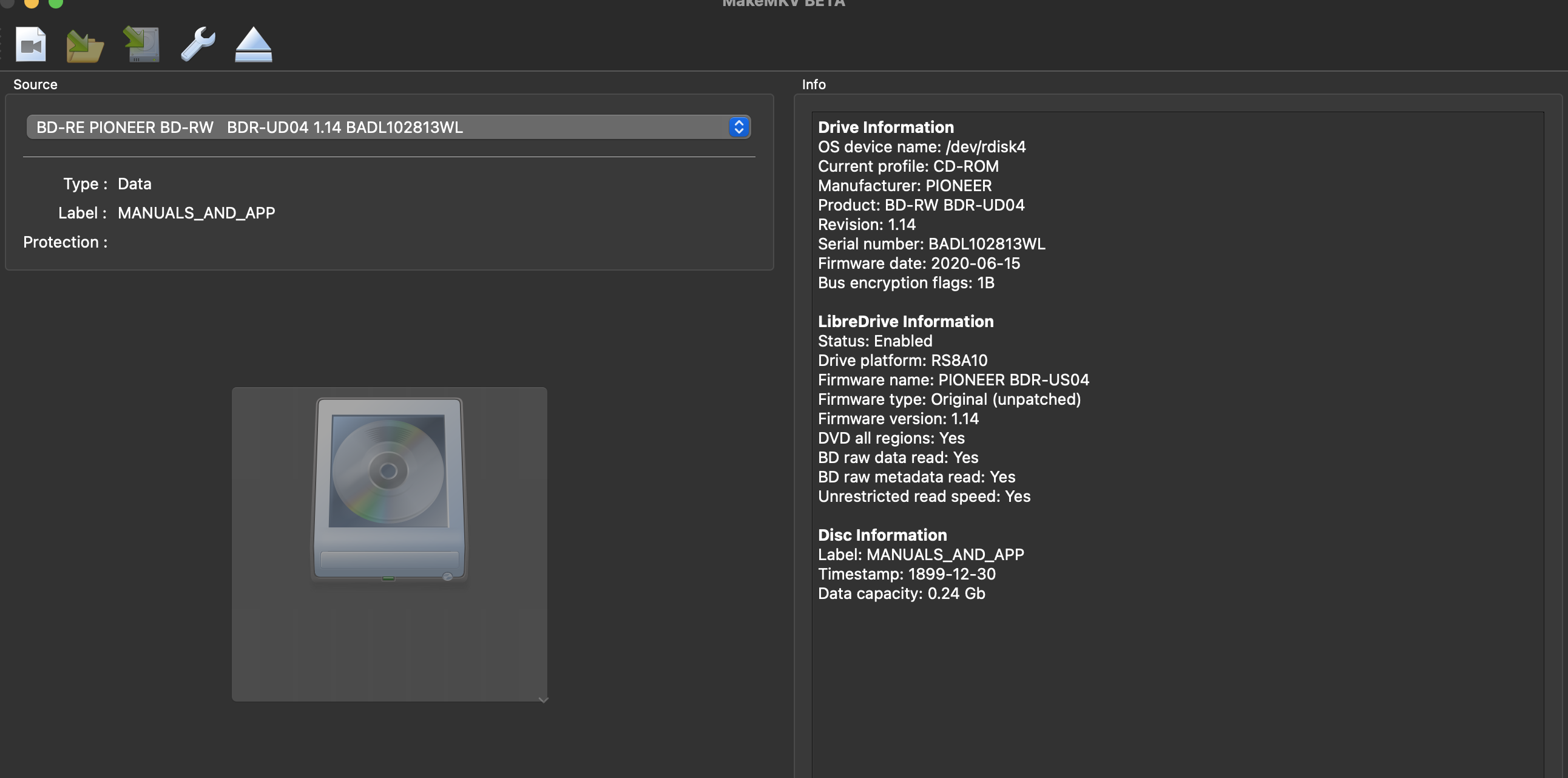

I bought the Verbatim USB-C Slimline drive for my Mac, however it does not see any Blu-rays other than the one it came with (PDF manuals etc). I've attached a screenshot of MakeMKV with the drive attached. No logs, and after a few minutes of knocking sounds it just ejects any disc I've tried, UHD or otherwise. Also tried it in a PC which I use for ripping with an internal UHD drive, and same results.
Any ideas for what I need to do? Maybe it's broken? Thanks for any help.

I've got the exact same Verbatim drive and same firmware you do. It works great on my Mac running Ventura 13.2.1.
Since yours recognizes the CD-ROM with the manual, have you tried a DVD or only UHD and Blu-Ray?
It's funny you should mention the knocking sounds... My drive was making these when connected to an old Windows machine I still sometimes use. I just figured the port wasn't providing enough power but since you've tried it on two machines that's less likely to be the reason. Were you using an USB-A to USB-C adaptor?
EDITED
EDITED
Re: Verbatim 34888 is super
If it's not a power problem the blue laser seems to be dead. CDs use the red laser in the drive. You should return it.

Thanks everyone for the advice. I've initiated a return.
Paul Cordingley
- Posts: 16
- Joined: Fri Jan 18, 2019 5:45 am
Update - the replacement arrived and it just works.
