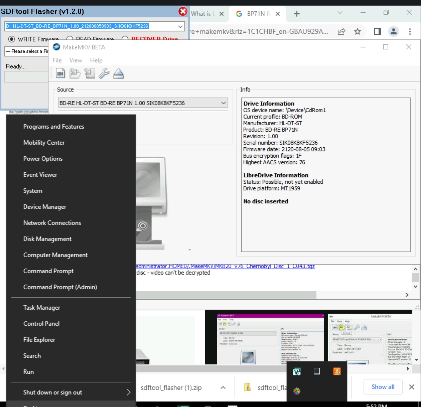

Good evening.
I took a gamble on a external UHD drive on Yahoo Japan. It's logitec branded. Internally it's an LG BP71N(see photo for details) I can't find any info on this forum about it I'm guessing it's not able to be flash modded. The price was good cost me 160AUD with shipping to the motherland so I'm not too upset.
Logitech number is LBD-PWA6U3CLW
Anyone got anything for me (Good or bad news)

Re: LG BP71n
I'm guessing it's a BU40N rebrand.
But might as well be safe do a read of the firmware and send it in to Mike the developer he will let you know where to go from there.

Post by B1gJ1mmy »
Best way for me to reach Mike I'm very new to this forum? I did a firmware dump using sdftool would that be enough.
Thanks.
Posts: 6152
Re: LG BP71n
That will be enough to start but a full backup maybe needed
The developer will tell you the details the forum or email will work to get in touch but since your new you probably can't pm so just email and sent the dump file with it

Post by B1gJ1mmy »
Ok I sent a message using the contact us a couple of days ago. However I could not attach a file that way. I cant see a direct email or anything.
I'll attach it here just for the sake of it.
dump_user_HL-DT-ST_BD-RE_BP71N_1.00_212008050903_SIK08K8KF5236.tar
(70.5 KiB) Downloaded 704 times
