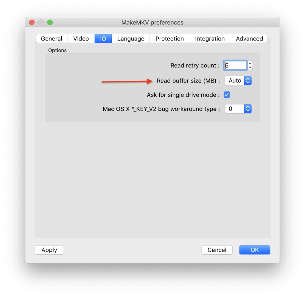

First guess is that your output is being speed-limited, and you get fast speeds while the (default) 512MB write buffer is not full.
A quick way to test this is to make it smaller - Preferences->IO, set the read buffer to 64MB. Does the slowdown begin sooner?

Thanks, Woodstock. Since I'm essential just functional with computers and the attendant "lingo", exactly were would I be checking for this buffer? On the blu ray drive, or on the computer itself. Sorry for the need for further clarification, but this keeps happening no matter the computer or the disc (just tried again).

In MakeMKV's preferences, there's an IO tab where you can change the setting.

It looks like the problem is solved. When I checked the I/O, the buffer was on "auto". I switched it to "1024", and I just cranked out my Ran Blu-Ray in 30 minutes, hitting 24mb/s at one point. Thank you again to all the folks who responded with the solution!
