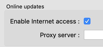

So, I have Enable Internet Access checked off in Online updates. Do you have any idea what else would prevent it from downloading the file?
I know that at the same time I did the update I also purchased a registration key. Could the key have an issue?
Posts: 4556
Re: UHD volume key not found 1.15.3
Enable Internet Access needs to be turned on for it to be able to attempt to download the necessary decryption keys.
Maybe it is a trick of language where when you say 'checked off' you really mean turned on. But if it is turned off, please turn it on.
