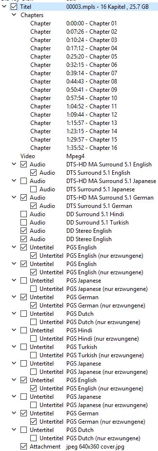

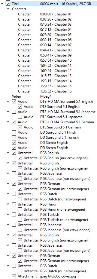

I only need the Director's Cut. As you can see it is part of 00003.mpls and 00004.mpls. Both contain the same segment parts, chapters, etc:
2019-06-05 09_02_50.jpg (90 KiB) Viewed 12718 times
2019-06-05 09_03_27.jpg (92.49 KiB) Viewed 12718 times
but the file size differs a little bit:
Salte00.mkv - 00003.mpls - 23.126.528.622 Bytes
Salte03.mkv - 00004.mpls - 23.126.292.734 Bytes
I checked the credits and intro but can not see any difference. As the segments are identical this seems to be logic. Which differences could be left?

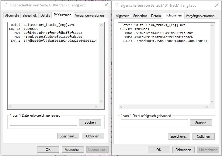

I tried to check the audio. By that I used gMKVExtractGUI and extracted the audio tracks, subtitle sup and chapter xml files.
The differences as follows:

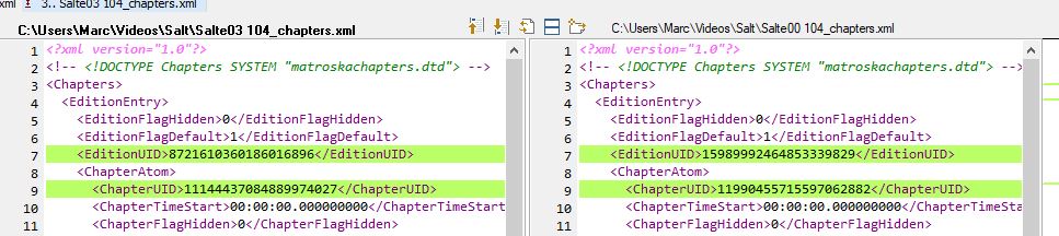

Through PSPad I found that chapters contain different "EditionUID" and "ChapterUID" :
2019-06-05 09_18_17.jpg (63.72 KiB) Viewed 12717 times
The HashCheck Shell Extension shows identical english DTS-HD MA audio tracks:
2019-06-05 09_21_01.jpg (58.13 KiB) Viewed 12717 times

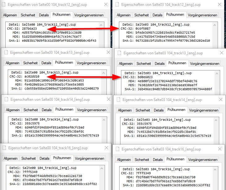

Then I compared all subtitle files (English and German) and found different checksums for two subtitle files:
2019-06-05 09_27_59.jpg (126.79 KiB) Viewed 12717 times
In the next step I will search for a tool to check the sup-files content as they seem to be encrypted or compressed.

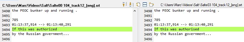

Now I used Subtitle Edit 3.5.9 to convert the SUP (text as images) file to SRT (text is OCR'd through Subtitle Edit). I checked the differences with PSPad again and its American vs British English:
2019-06-05 09_51_39.jpg (26.75 KiB) Viewed 12717 times
Wow. So much work for this little detail ;)
Result:
Salte00.mkv - 00003.mpls - American English
Salte03.mkv - 00004.mpls - British English
I'll go with AE.
