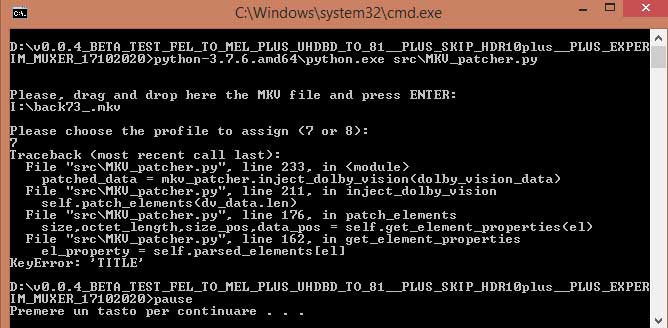

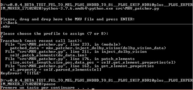

ragico
Posts: 263
Post by ragico »
yusesope wrote:
Sun Oct 18, 2020 6:35 pm
Yep, underscores are the heart of my hack ... without them the patcher can't work!
Sorry for the stupid question: where you put the underscores?
Example the film title is Back. Should I write Back73_ (if I choose prof.7)?
I have tried different ways with these underscores and, after the Mkv_Patcher always get this:
Where I am wrong?
By the way if I load the file from toolnix in makemkv I got DV and also hd audio and plays in Firestick and Ugoos and Shield.
But the file generated from Mkv_Patcher only plays in hdr.
yusesope
Posts: 221
Post by yusesope »
ragico wrote:
Sun Oct 18, 2020 6:53 pm
Where I am wrong?
:lol: :lol: :lol:
In MkvToolNix, before start muxing, go to the "output" tab and in the "file title" field enter the title you want followed by 73 underscores in the case of profile 7 or 37 in the case of profile 8 (literally 73 or 37 underscores)

ragico
Posts: 263
Post by ragico »
yusesope wrote:
Sat Oct 17, 2020 11:19 am
#profile 7
Movie Title_________________________________________________________________________
#profile 8
I have done it Film title followed by 73 underscores.
Still, after MKV_Patcher only get Hdr as mediainfo confirms. This is mkv_patcher. Is there any error?
yusesope

ragico wrote:
Sun Oct 18, 2020 7:38 pm
#profile 7
#profile 8
Yep, there is a problem with the patcher!
In the next few days I will ask you to send me a sample using a hex editor so I can correct the problem!
I'll explain what to do but not now because I'm going to sleep ...
I see "Premere un tasto per continuare" in the attached image.
Are you Italian too?
jlpsvk
Posts: 50
Joined: Thu Sep 06, 2018 11:33 am
Post by jlpsvk »
File Title metadata tag is not the same as filename.. :D
Yes I am Italian
ragico
Posts: 263
Post by ragico »
jlpsvk wrote:
Sun Oct 18, 2020 7:53 pm
Pls explain
yusesope
Posts: 221
Post by yusesope »
ragico wrote:
Sun Oct 18, 2020 7:58 pm
Yes I am Italian
Weeeeeeeeeeeee Paesà. :lol: :lol: :lol: :lol:
Nei prossimi giorni vediamo di risolvere!
E' strano che non funzioni ma il mio patcher non trova il titolo assegnato da MkvToolNix!
Sicuro di aver scritto il titolo nel campo "titolo file" (tab "destinazione")?
