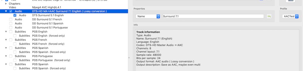

Also, I was able to hack a conversion profile for MakeMKV 1.15.3 that seems to have converted a multichannel DTS track into a multichannel AAC track (using FFmpeg) while creating the MKV file. I've tested it a single time and verified the output using mediainfo.
I created a file with the contents below named aactest.mmcp.xml and put it in ~/Library/MakeMKV/aactest.mmcp.xml

This does what seems to be some undocumented things, so there's no reason to think it'll work into the future. That said, since Sonos has made the unfortunate decision not to support DTS on the ARC, it'd be nice if a conversion profile like this became a default option in MakeMKV.
Source:
Output (audio #2 has the AAC):
Audio #1
Format                                   : DTS
Duration                                 : 1 h 53 min
Bit rate                                 : 1 509 kb/s
Channel layout                           : C L R Ls Rs LFE
Stream size                              : 1.20 GiB (5%)
Audio #2
Format                                   : AAC LC
Format/Info                              : Advanced Audio Codec Low Complexity
Codec ID                                 : A_AAC-2
Bit rate                                 : 469 kb/s
Channel layout                           : C L R Ls Rs Lw Rw LFE
Frame rate                               : 46.875 FPS (1024 SPF)
Stream size                              : 381 MiB (2%)

Mate, thank you very much for this. I didn't think Sonos ARC supported AAC though? Does that mean my file needs to be different to convert to AC3? Also, is it as simple as putting that file in the directory you listed above and run MakeMKV and run it or do I have to do something inside of MakeMKV to point to that file?
I also need to capture all forms of DTS. DTS - X, DTS-HD, DTS-MA, DTS7.1, DTS 5.1. However, True HD the Sonos ARC supports. So if I can get the DTS stuff into an AC3 file, that would be awesome.
Not to risk this too much, but True HD 5.1 would even be better because its lossless whereas AC3 is lossy. Not sure if that can be done. I can be satisfied with AC3, but True HD 5.1 would be the ultimate.
Note that the ARC supports True HD which includes ATMOS.

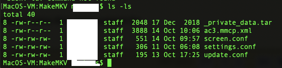

OK, so I tried this method, but I cannot select the profile aactest from MakeMKV. It just shows the default, AAC-Stereo, FLAC, WDTV. I was expecting aactest to show there.
The file is in: ~/Library/MakeMKV/aactest.mmcp.xml
Posts: 4572
Re: Dolby Vision and 1.15.1
@Larrikin
I assume you found other files in ~/Library/MakeMKV ? It is the default data directory on Mac, but the file goes in wherever the MakeMKV data directory is in MakeMKV's preferences.
Also, Finder thinks the file is a XML Document.
And the permissions are at least you get to Read & Write, staff is read, everyone is read.
And you restarted MakeMKV after dropping the file in place.
And Expert mode is turned on in MakeMKV's preferences.
Are there any interesting messages about conversion profiles in the log?
As for the Sonos ARC not supporting AAC… I suppose anything is possible, but it is hard to imagine that it doesn't since they claim support for Apple Airplay 2.

I think I've done all of that and I also think you are right on AAC. For now, let's try AC3. Here is a screenshot to show you the permissions in the directory. Note that I used vi to create the file.

dcoke22 wrote: Tue Oct 13, 2020 11:02 pm @Larrikin
Just to add, I had a fiddle with FLAC. Look at where that profile resides: /Applications/MakeMKV.app/Contents/MacOS/../Resources/appdata.tar:flac.mmcp.xml
It also shows on my screen before I click the button to make the MKV that its clearly going to change the DTS to Flac on the conversion. When I had the AC3 one loaded, it didn't
Larrikin
Posts: 37
Joined: Fri Oct 09, 2020 9:56 am
Post by Larrikin »
OK, so I stuffed up. My default data directory in MakeMKV's preferences was wrong and had changed from the default. The profile now shows. I'm about to go again and create the MKV. mate, really appreciate all your help :)

OK, so an update. AAC still only produced Stereo on my Sonos ARC. However, working with everything you did for me, I changed the codec to AC3, and boom - it works! Thanks so much mate!!! Dolby Vision and AC3 :)
