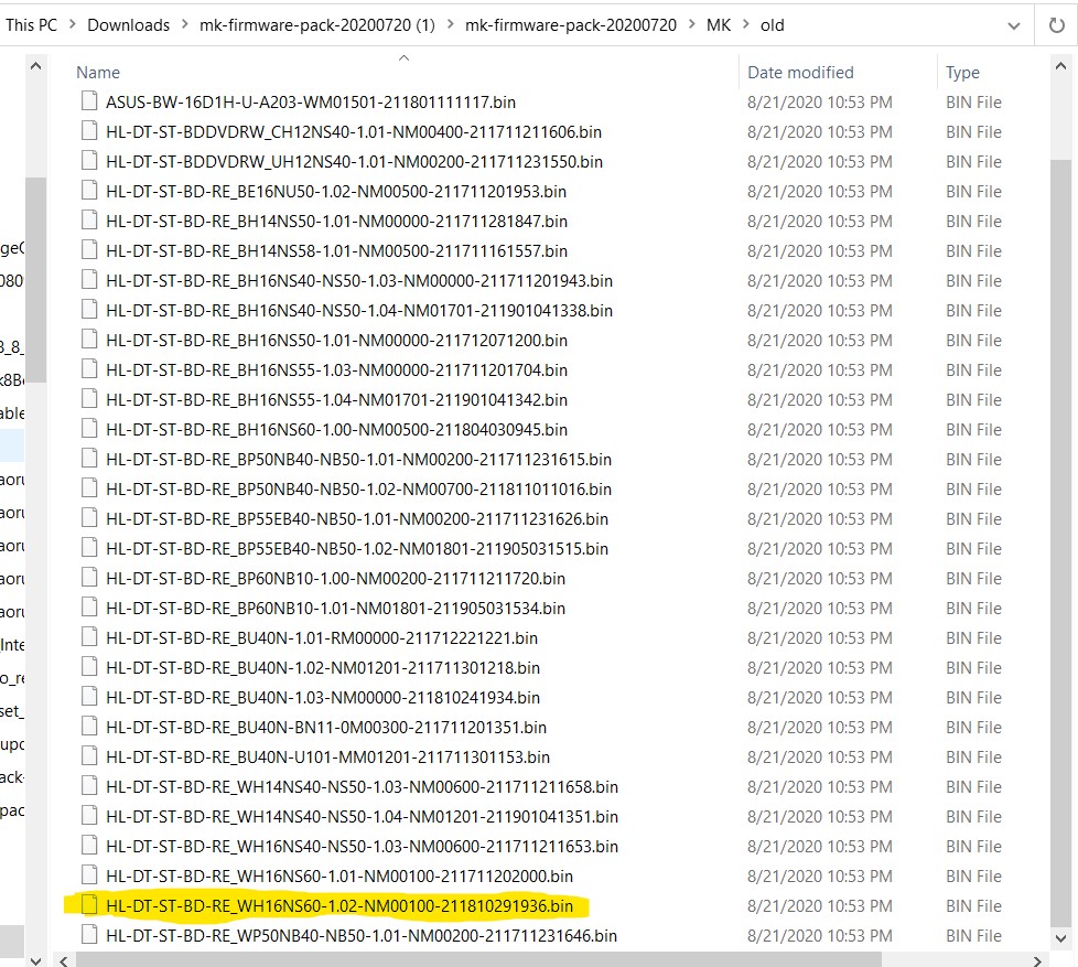

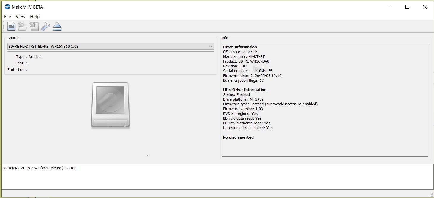

If I accidentally flashed the 1.03MK firmware on my LG WH16NS60 drive can I use "SDFtool Flasher" to Flash the 1.02MK file (see screenshot)? Will I need to choose the ENC button since its 1.03?
Thank You
Is this the correct version 1.02MK to flash?
mk firware list.jpg (292.15 KiB) Viewed 1100101 times
My current settings of drive
LG drive screen shot v103.jpg (121.19 KiB) Viewed 1100101 times

kastaway33 wrote: Sat Aug 22, 2020 3:18 pm If I accidentally flashed the 1.03MK firmware on my LG WH16NS60 drive can I use "SDFtool Flasher" to Flash the 1.02MK file (see screenshot)? Will I need to choose the ENC button since its 1.03?
Thank You
It is my understanding that no MK firmware is encrypted,so your current firmware is not encrypted, therefore, no. Yes, that highlighted file is 1.02-MK.
Please, someone correct me if I am wrong..

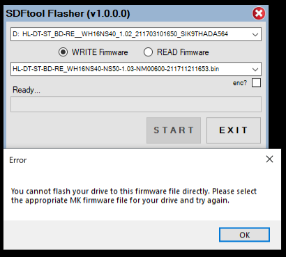

I'm getting this error message and not sure what the issue is. I'm wanting to flash to WH16NS60-1.02 MK to get rid of the sleep bug (I got the same error message when I tried that version of firmware.)
Here's my drive info:
Product: BD-RE WH16NS40
Revision: 1.02
Serial number: SIK9THADA***
Firmware date: 2117-03-10 16:50
Highest AACS version: 72
Firmware version: 1.02
Posts: 4912

OK, if you want to flash to WH16NS60 1.02-MK, why are you trying to flash firmware WH16NS40-NS50 1.03 MK????
Your drive is on WH16NS40 1.02 so you should be able to directly flash WH16NS60 1.02-MK firmware and be done!
