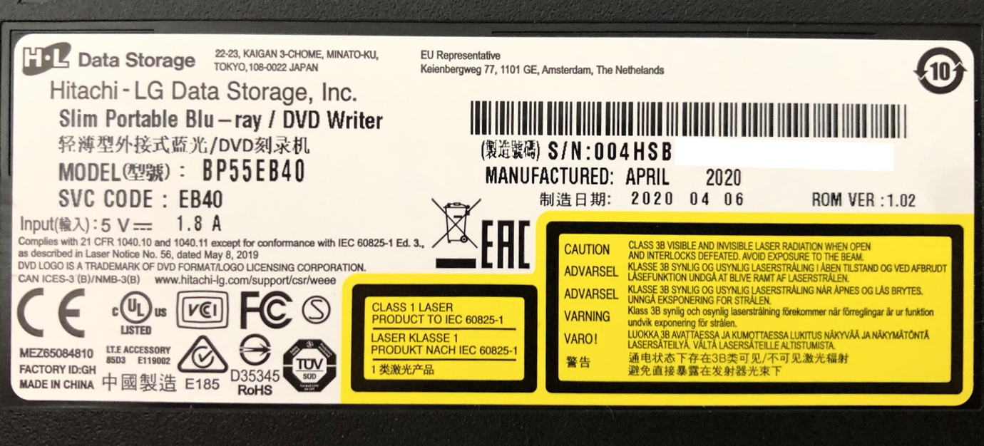

I'm using an LG BP55EB40 with MakeMKV and tried flashing its firmware to make it LibreDrive-enabled. Since its firmware is version 1.02 (bought it like this), it's not enabled out of the box. Using information found in this post (thank you!), I thought it should be pretty much straightforward. I have, however, not been able to get it done. Does anyone have an idea?
My equipment:
• MakeMKV v1.15.1 [darwin(x64-release)]
• current sdf.070.bin consumed by MakeMKV
mk-firmware-pack-20200415
• MacBook Air 2019 running macOS 10.15.4
• LG BP55EB40 connected via USB (in its original slim enclosure, no disc inserted this time but disks have been opened and imported with it already in the past)

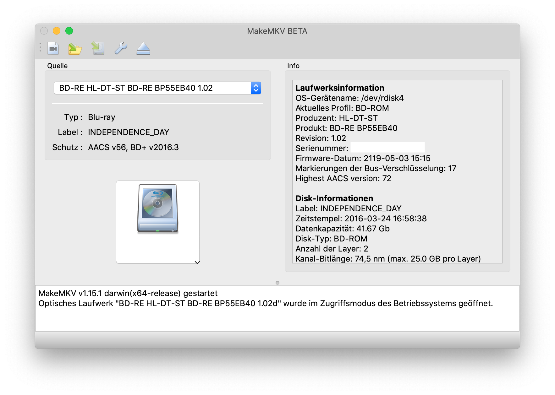

Weird thing is that MakeMKV does not show any LibreDrive information in its application window. This has happened for other people as well, although not for this specific drive and with no apparent solution. I have no clue as to why that may be. Perhaps it's related to the flashing problem? See screenshot attached.
Any help would be very much appreciated.
drive sticker.jpg (331.43 KiB) Viewed 42381 times
