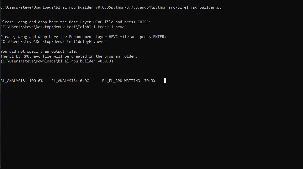

Hey Woodstock, the EL i've already separated from the MakeMKV backup. So I had both streams, base and enhancement - are you saying that even though I have a base layer and a EL, there is still DV info on that base layer? That would make sense if true, but I was under the impression that there isn't anything special about the base layer, it's the EL where all the DV info lives. So shouldn't I be able to compress the base layer without removing the DV info? Then just use yusesope's tool to add the DV EL back?
It was an attempt... The massive BL_EL_RPU file that I created plays on my LG C9 but it stutters like mad making me think it's too much for the SOC on the C9 to handle. I get the DV tag showing up in the upper right and it looks amazing... just doesn't play right. This is my attempt to lower the overall bitrate of the stream
I have previously used NVencC64 command line to compress the base layer of Gemini Man and it still worked in yusesope's tool. Once muxed to ts file, mediainfo shows it as DV. (I do not have a Dolby Vision TV so could not test the files) although I did provide some sample links. I'm not sure if I used the right tsmuxer version but you could test these and see if they work for you before going any further.
See https://www.makemkv.com/forum/viewtopic ... 145#p87824
If they work for you and you want to give it a try, let me know and I can give you the nvenc command.

Marty, thank you so much for the response man! I didn't see that thread you posted, but it's exactly what I'm experiencing!
I'm going to give your test files a run on my LG C9, if they work and report back DV... You're a savior. I'll check out NVencC64 too... I'm guessing I'm just losing some DV metadata in Handbrake when I'm compressing. It's funny, handbrake nightly transfers HDR10 data just fine (if you use the right "advanced options" settings...) but completely erases DV data in the base layer...

For this type of experiment, I recommend using the 0.0.4 alfa version of my tool.
You're right when you say "it's the EL where all the DV info lives" but keep in mind that the info contained in EL are "calibrated" on those inside BL.
If you re-encode BL, logically, you should also modify EL.
No one has yet reversed the algorithm needed to generate new RPU metadata (and, in the case of FEL layers, new frames).
Imagine a guy (BL layer) with a weight of 180Kg who, after following a diet, reaches a body weight of 80Kg.
His clothes (EL layer) are now unusable but the clothing stores (the algorithm) are closed due to the quarantine.
The guy will be forced to use his old clothes.
He will always have clothes on but his style will be a little "sui generis".

I've experimented a lot, re-encoding the BL layer with staxrip/x265 and 0.0.4alfa always merged it with EL without any problem. Also I have an m9702 so I can just mux the re-encoded BL and EL into full UHD BDVM structure (with tsMuxeR) and DV works. I spent hours by testing the results (re-encoded BL+EL), comparing them scene by scene to the HDR10 base layer and also to the full untouched UHD BluRay on my LG C8 Oled and I really beleive this method works perfectly. I've never noticed any difference between the files with re-encoded BL and the full UHD BluRays, but the differences were pretty significant comparing them to the untouched HDR10-base layer. I used the following movies for my tests: Aquaman, The Meg, Fantastic Beasts 2, Midway, Game of Thrones S08E03.
Using the right x265 settings, only the bitrate will be lower but everything else (including the HDR10 metadata) will be the same as in the original BL so I don't see why wouldn't it work.

I always use crf 14-18, which generates variable bitrate. For newer movies that were recorded with digital cameras and have completely smooth picture I usually lower the bitrate to 40-60% of the original, but for grainy stuff (older movies recorded on film) I never go below 65%. Besides that, I mostly use default "slow preset" settings with a few changes (deblock -3:-3, no-sao, no-open-gop, bframes 8 ).
