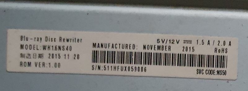

Hello guys, i need some help.
I have an LG Blu-Ray Disc Re Writer WH16NS40 SVC: NS50
I was with the firmware 1.00, from the LG website, i download the F 1.03 and after i did the update, the problems started.
So, after the updated, the LG didn't read originals BluRays.
A non original CD yes, a non Original DVD yes.
Then i found your video and try to downgrade to the 1.02 firmware.
No still read a regular CD, but nothing else, and after i try to put a DVD or BR the LG just stops working and i need to reset my PC.

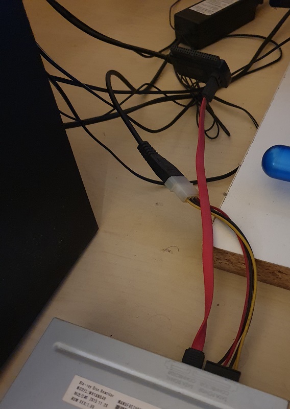

If it helps, this is how i use my LG (when i bougth my new NZXT Source 340 Matte Black Razer Edition i didn't see that is no space for the LG
) so i use like this (i don't know if is a problem or not really)
So, someone can help me?
What can i do to recover my LG?
Thanks from the Help
