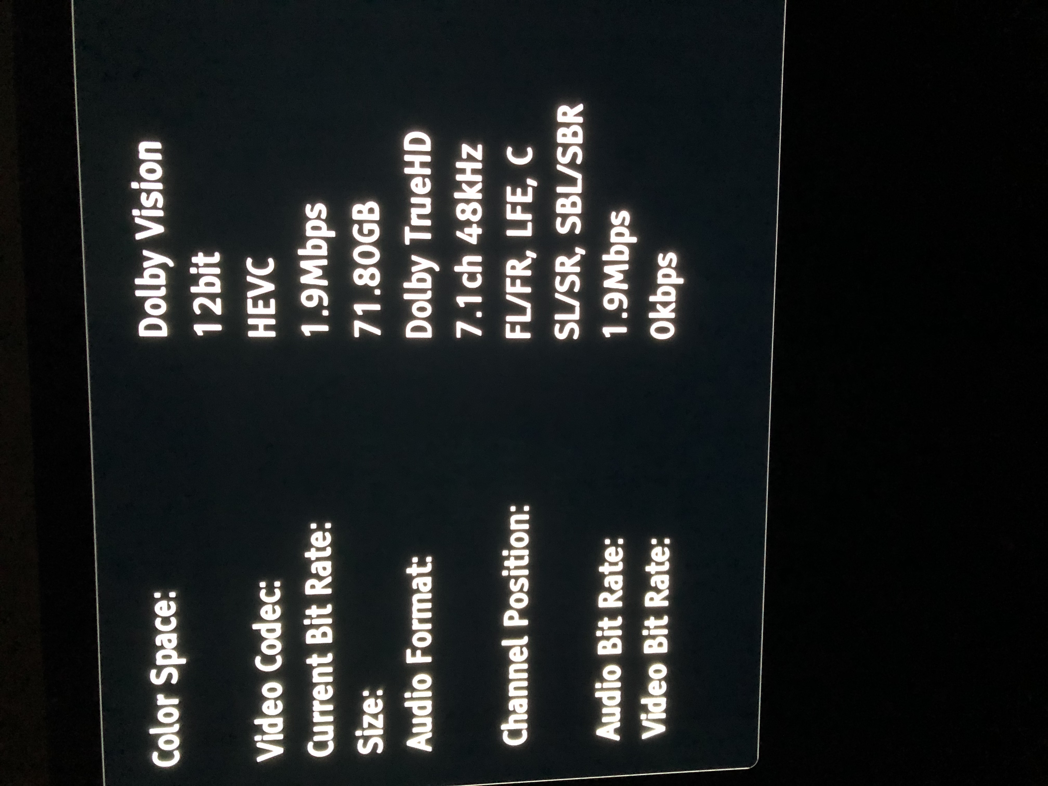

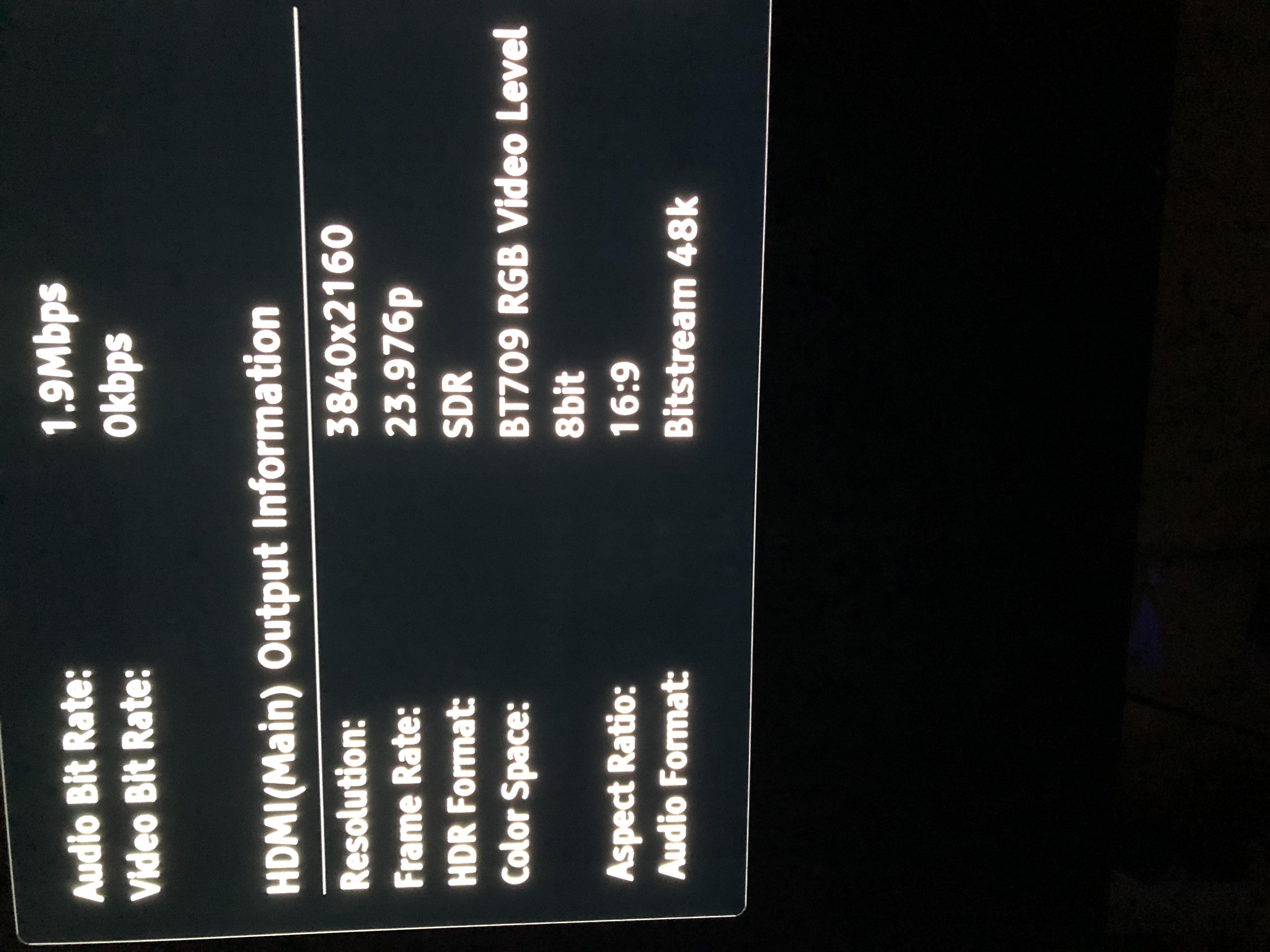

Hi Yusesope, here are the shots from the Oppo, 1917 that won’t play and reports as 8bit output, which makes sense and Missin Impissibke Fallout which plays fine, both are supposed to be FEL.

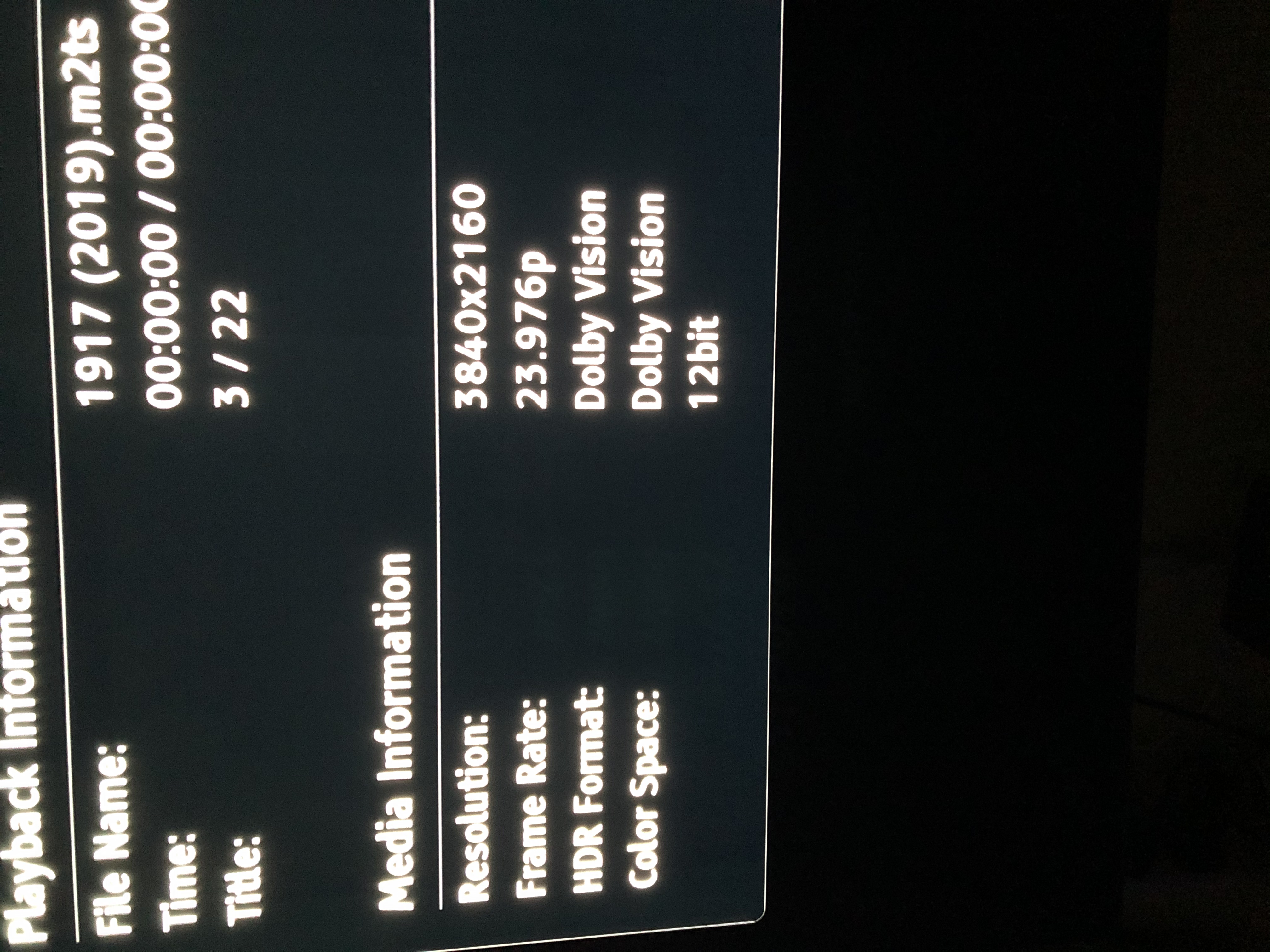

Here are the Mission Impossible Fallout pics

1917 worked great after ripping the BL, EL with TSMuxer, and using Profile 5 with MP4Muxer. It was, hands down, the best visual experience I've had in terms of Dolby Vision. Everyone that has DV needs to see it.
Hi, can confirm this mux of 1917 that didn’t work on the Oppo works in Dolby Vision and Atmos on 2019 shield pro, shame I will have to have 2 muxes of some FEL movies till it’s sorted, particularly because the Oppo is a better picture, the Colours are more balanced.
Is there any other way to try and mux so we get a file that works on both?
