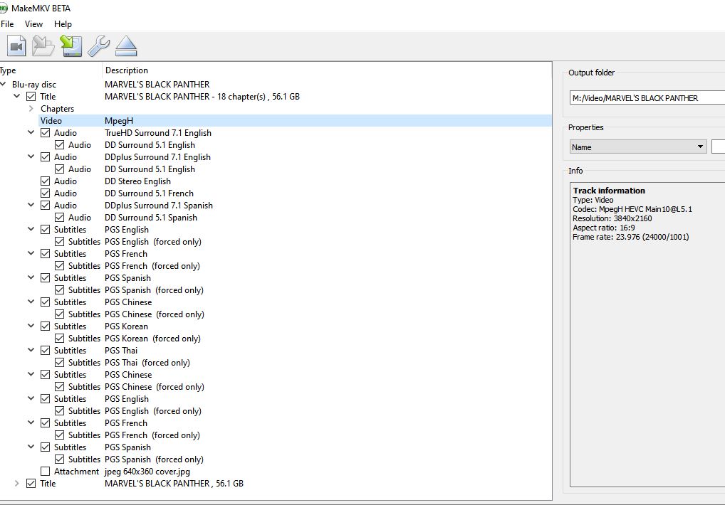

Ok - I am on cloud 9. I just tried:
1) Game of thrones S8 UHD rip using MakeMKV
2) Extract .thd and convert to .thd+ac3 using eac3to
3) Using tsMuxeR nightly build, imported the two video layers from the mkv created in 1) alongside thd+ac3 created in 2).
It works beautifully on the X700! :-)
- Plays in Dolby Vision (confirmed by pressing info on X700 remote)
- Plays Dolby Atmos. My Denon AVR reports the stream as “Dolby Atmos - TrueHD” and the bitrate is normal (regardless of what mediainfo says).
- Lip sync is perfect! I had a hope this would happen because as I said before - lip sync is perfect whenever playing discs on the X700. It is only LPCM I see the issues.
This is phenomenal. No compromise compared to watching the disc, but with the benefit of it being totally silent from my SSD. Also, far less disc thrashing when creating the files due to no more need for the intermediate MP4.
Within 24 hours I’ve gone from regretting buying the X700 just to play DV files (due to lipsync with LPCM) to witnessing the dawn of (dare I say) an effectively no compromise situation with respect to DV remuxes. And the X700 becoming an invaluable piece of equipment. Wow.
