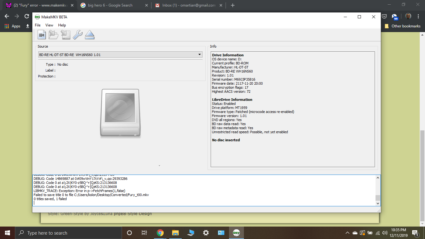

I'm jumping between two computers, but libre drive is enabled. flashed to 1.01, haven't reflashed. just finished backing up big hero 6, so don't think its the drive. here is another log.MartyMcNuts wrote: Thu Dec 12, 2019 12:35 amIt appears the host certificate has been revoked by your drive. Is libredrive mode enabled for your drive in MakeMKV? If you can't use libredrive, you will need to wait for MakeMKV to be updated with new certificate.omk1980 wrote: Thu Dec 12, 2019 12:17 am Thanks Samurai. I appreciate your help on these boards. disc has been cleaned a couple of times. other discs are working fine. I figured it was a disc, but this is the first 2.1 i've tried to backup

- Screenshot (2).png (132.95 KiB) Viewed 28813 times

haven't reflashed. not sure why it's showing up like that. libre drive is enabled on both computers, using an same external drive on both.Billycar11 wrote: Thu Dec 12, 2019 12:52 amYou didn't flash an mk firmware? I see you have 1.01 that work work with UHD unless it's been flashes to 1.00 or mk 1.01+omk1980 wrote: Wed Dec 11, 2019 11:25 pm Hi-

- Posts: 6181
Re: "Fury" error
Just responding to the firmware if it has 1.01 mk then leave it. The log showed no libredrive for some reason it said it was in os mode
