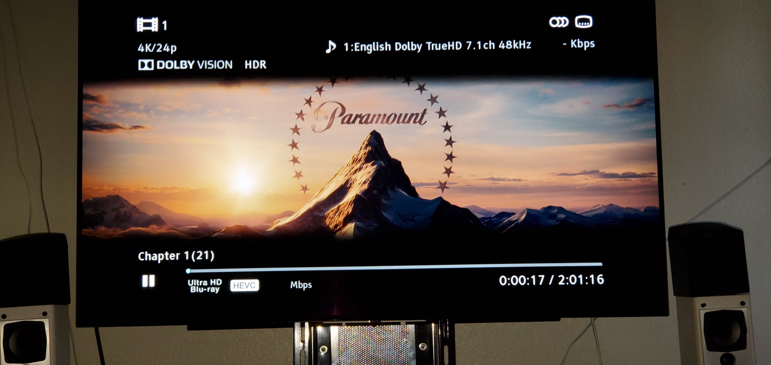

I'm getting the same result :( ... I'm still going to try it on the oled tonight...
EDIT:, nop, no go in the TV(which supports atmos and dts=x). no audio detected....
But it's still a step in the right direction. FFmpeg dev should be able to fix that.
