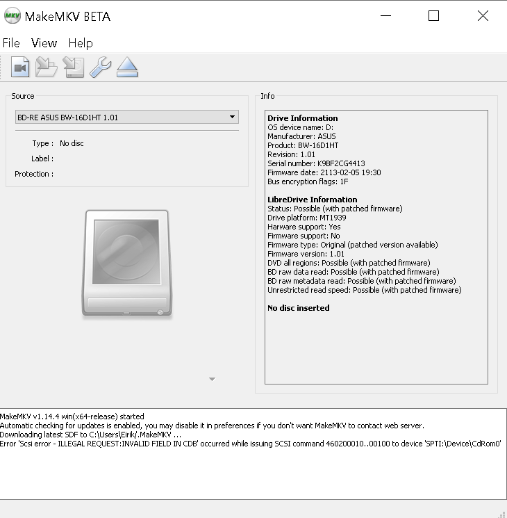

I decided to buy a second hand ASUS BW-16D1HT. Got it down to 10$ so worth the risk. This is just a temporary drive and I will be buying a uhd drive from one of the sellers here on the forum when I get home from vacation.
So the drive is to old to support UHD, but can it still be used to rip 1080p blurays?
If yes, what firmware do I need flash to it for best performance, and what is the correct way of doing so? I am only asking since in makemkv it says
Unrestricted read speed Possible (with patched firmware)
Posts: 5075
Re: UHD drives
ProphetSe7en wrote: Fri Jul 26, 2019 6:31 pm I decided to buy a second hand ASUS BW-16D1HT. Got it down to 10$ so worth the risk. This is just a temporary drive and I will be buying a uhd drive from one of the sellers here on the forum when I get home from vacation.
I believe your drive is already on the latest firmware for that earlier model. No need to do anything. Just rip your blu-ray discs as normal. There's no patched firmware yet for that drive to enable libredrive access.
