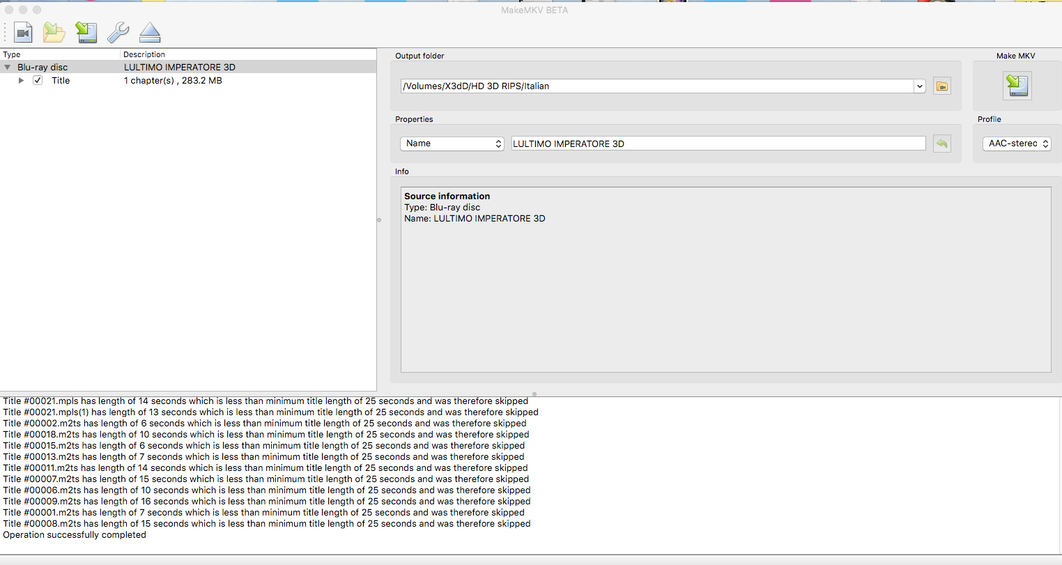

I have an issue with this disc as well. Mac, MakeMkv 1.14.4, Opens disc and shows only one file of 283.2 mb which copies fine but it's just the title.
Anyone?
This is the Italian 3d disc.

I'm having the same issue.
The only the 282MB header video is located.
But the disc does contain 38GB and 11GB m2ts files under BDMV/STREAM. Copying all the content to a HD and trying to open various content files with makemkv didn't locate those files.
