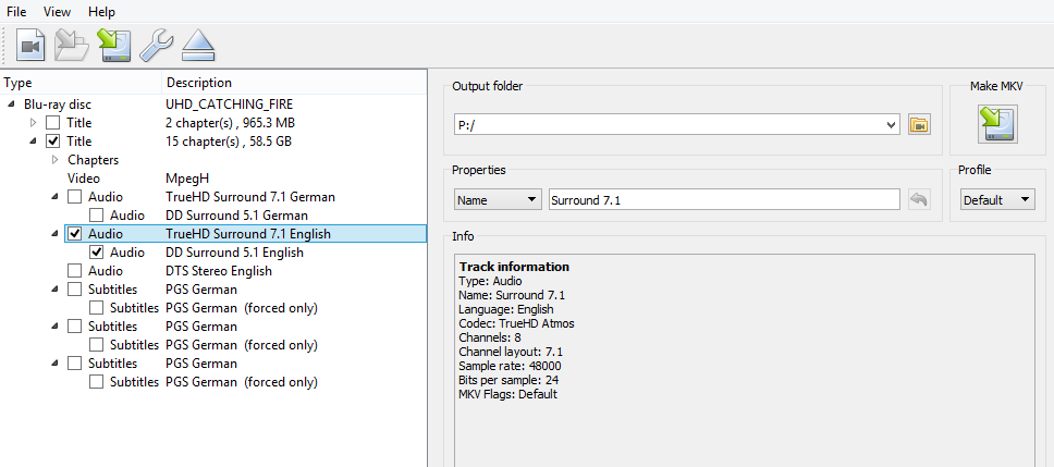

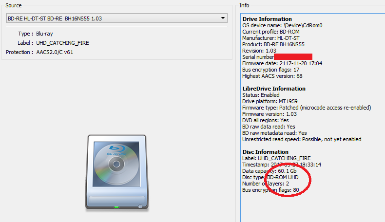

Today I received my third copy of this movie - the German release. It came in one of those super thin flimsy cases which some people may like, but for some reason I always associate them with "low effort releases" - movies that barely make it to Blu-ray with no expectation to sell well, where the disc doesn't even have any proper artwork on it (although this one does) etc.
The disc itself popped out of the... thingy in the middle that's supposed to hold it in place, but luckily it wasn't scratched and yes, it did turn out to be a very low effort release - only German subs and only 2 audio tracks - German and the original English:
Not much to see here.
Even the title of the file was the default "title_t01.mkv" because they didn't bother naming files...but, as you can already tell by the screenshot above, it works! But here's the funniest part - it only works BECAUSE it's such low effort release as there's only ~60 GB of data on the disc which makes it a dual-layer disc:
Third layer would have been too much effort.

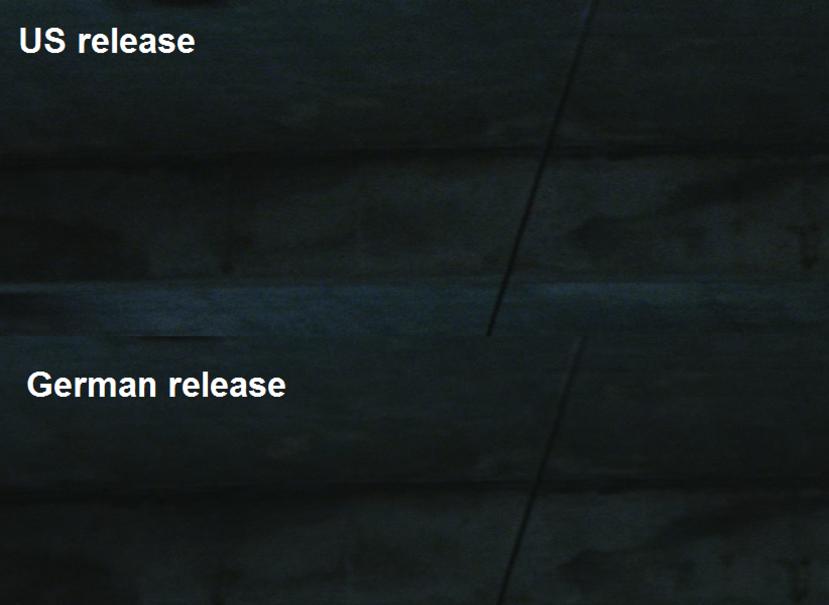

There is a "catch" here (no pun intended), though. According to caps-a-holic (https://caps-a-holic.com/c.php?go=1&a=0 ... 76&i=8&l=0) the video of the US release runs at a bitrate of 62498 kbps while the German one "only" at 42498 kbps (the Atmos track is also slightly lower bitrate). That's how they've managed to downsize it enough to fit on a 2-layer disc.
That said, when you look at all the comparison images, most of the time it only looks like there's a different grain structure on the German disc which probably comes with the stronger compression. The only image where it's clear to see that it's a more compressed release is picture #6, specifically the gray ceiling. Here's a 200% zoom of it:
but you can see it best when hovering over the image at caps-a-holic using the "Fullscreen comparison" option.
So that's that. On one hand, mission completed - I managed to finally rip the movie, but on the other hand... it's a more compressed version. I know, it probably won't even be visible when watching, but still, it's a bit of a bummer. I doubt I'll continue to search for a working copy of the "good" version with higher bitrate. Maybe at some point I'll actually buy an "official" drive and revisit this to see if it will read the other two triple-layered discs, but for now I'm done.
