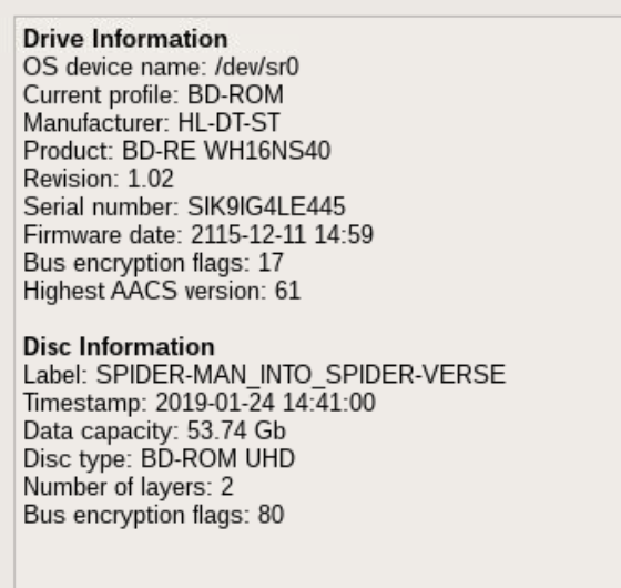

I have a similar question as the original poster.
My drive is WH16NS40 without the -NS50 after it. I bought it in 2018 and the version is 1.2. The drive says it was made in 2016. I downloaded the MK firmware files but I only see folders with WH16NS40-NS50 or WH16NS40-NB50. What do I use and how do I update the firmware?
I have attached a screenshot of my drive information.
I am using Unraid with MKV version 1.14.3
Thank you!
Screen Shot 2019-03-26 at 5.13.43 PM.png (146.67 KiB) Viewed 23183 times

SkippyTheMagnificent wrote: Tue Mar 26, 2019 9:18 pm I have a similar question as the original poster.
Thank you!
It appears to recognize UHD discs. Why do you need to update it?
