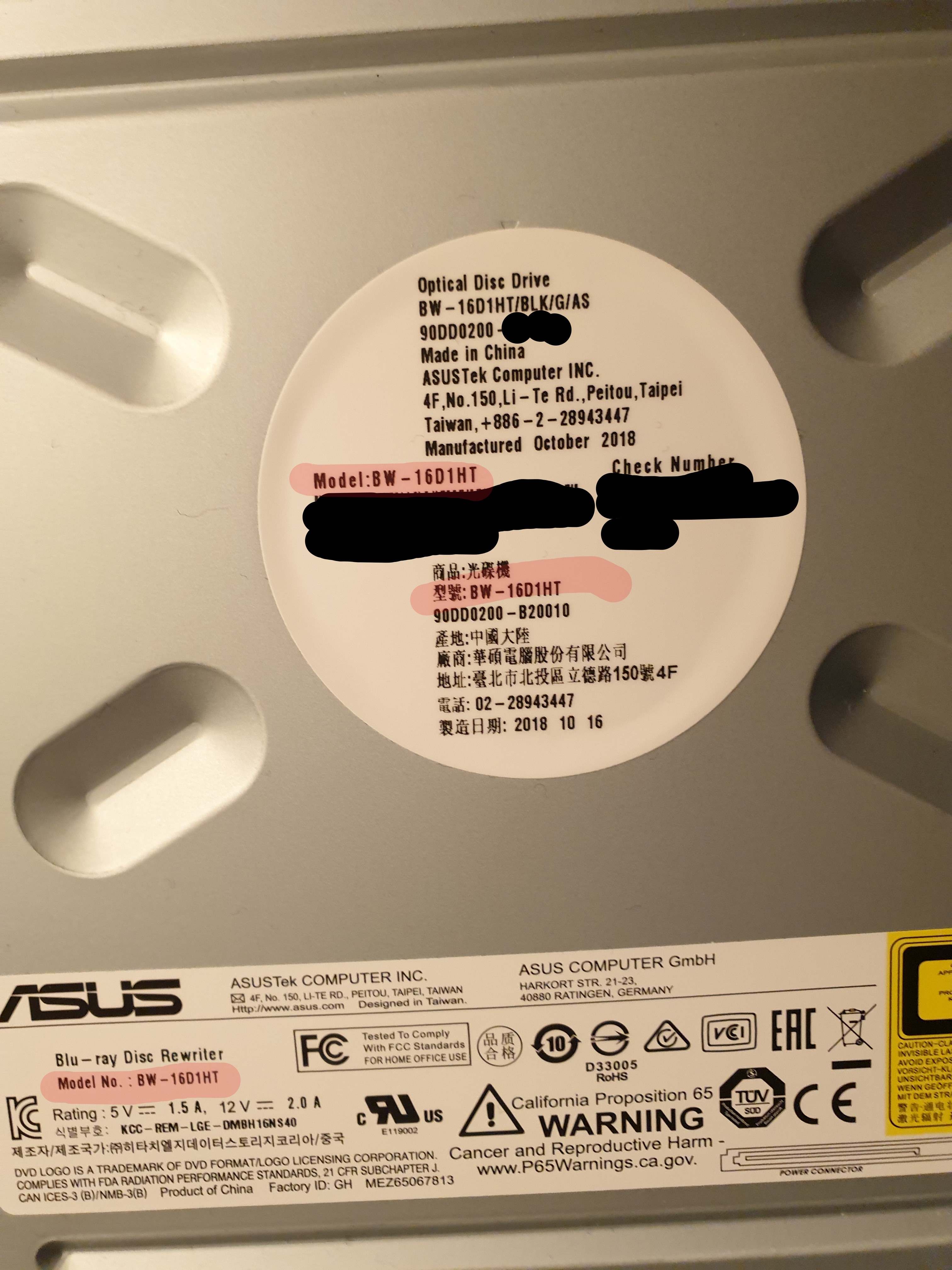

Hello guys,
I bought the Asus BW-16D1HT. Works just fine. Now I want do downgrade the firmware with the tool provided by MartyMcNuts.
But I ran into a Problem, the label on my Player says "Asus BW-16D1HT" , but makeMKV, Windows and the tool recognize it as:
"BD-RE ASMedia ASM105x 3.03 "
Also the other tool from the polnish Webside doesnt recognize it neither.
See the pictures.
So, what do I do now to make it work? Really want to use my 4k Blu-Rays.

MisterXYZ wrote:
Wed Mar 20, 2019 7:17 pm
"Also the other tool from the polnish Webside doesnt recognize it neither."
You have an USB enclosure that damages so-called INQUIRY data (drive model and version). While LibreDrive runtime is smart enough to detect this and recognize the real drive behind enclosure Id data, other tools are not.
Your options:
1. Use (temporarily) any other USB enclosure, just to flash the drive
2. Connect the drive directly to SATA, again only for flash
3. Patch a "patched" flasher (requires some skills)
4. Wait for LibreDrive universal flasher to arrive (this won't happen overnight, to say the least).

MisterXYZ wrote:
Wed Mar 20, 2019 6:32 pm
Hello guys,
See the pictures.
That ASUS flasher in your pic is the 3.02 flasher. Please go to thread below and download the modified flasher + firmware.
viewtopic.php?f=16&t=18933
Try this flasher and report back to us.

MartyMcNuts wrote:
Fri Mar 22, 2019 12:28 am
Hello guys,
See the pictures.
Tryed it out, worked!
Flash took ony 30sec and done.
Even with the SATA to USB Adapter.
Thank you very much:)
