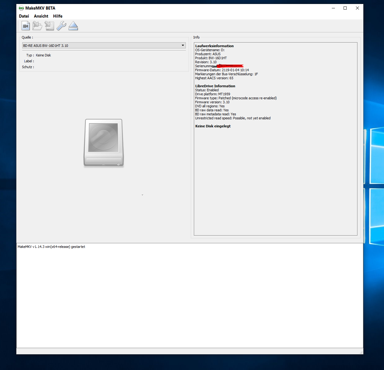

Hello today I have of Verbatim BD-R XL 100GB described with my LG BH16NS55 where with Dosflash firmware 3.02 to Asus BW-16D1HT have changed, and with Mike new firmware ASUS-BW-16D1HT-MK 3.10 have flashed. Great that the writing ability remained.
Great forum! Thank you
Screenshot (1).png (145.91 KiB) Viewed 43792 times
