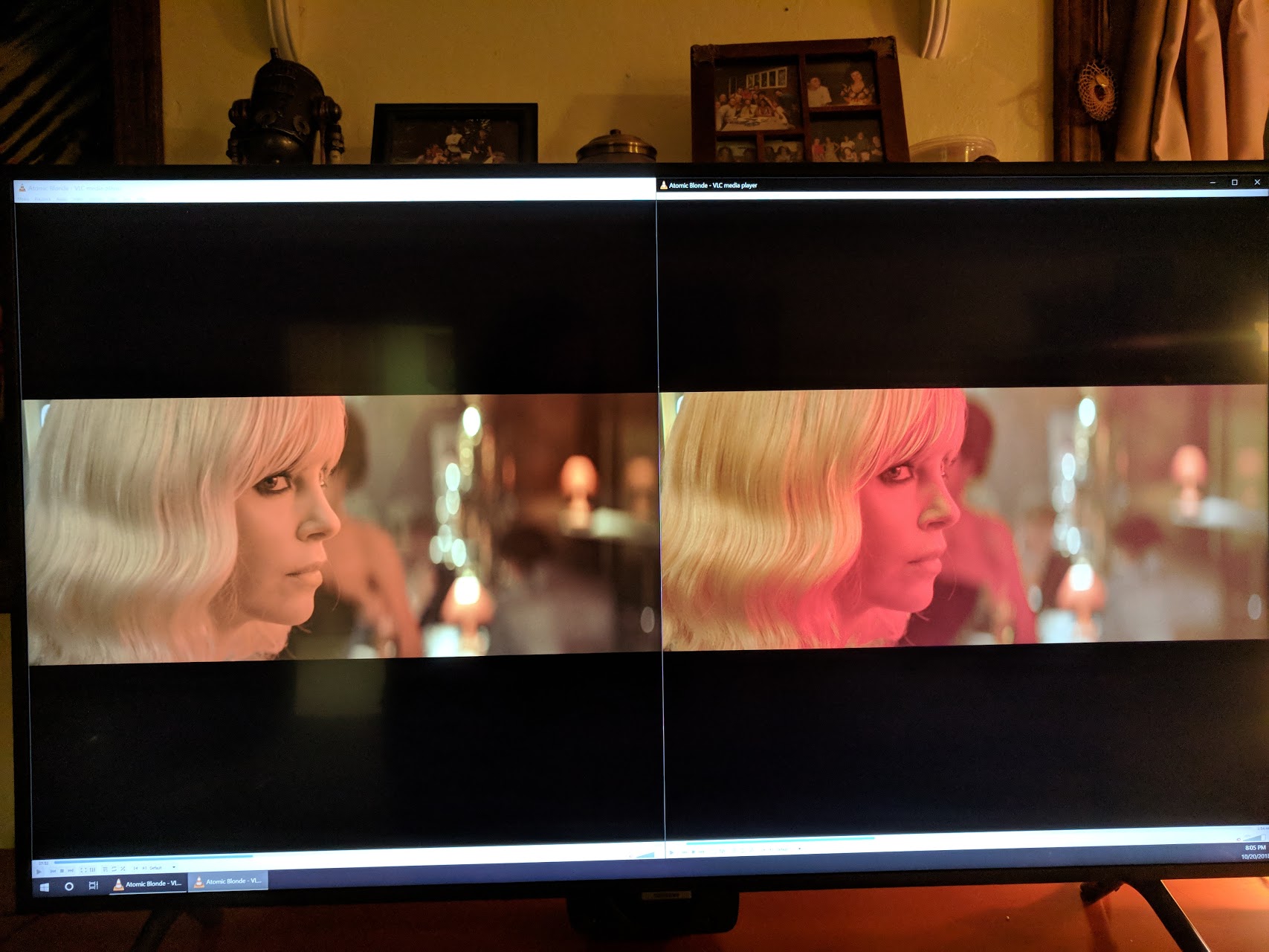

I recently got myself a 4K HDR TV and a UHD-friendly drive (thank you jonghotti).
I made my first couple MKVs of some 4K HDR discs and was excited to see how they would look vs the regular SDR blu-rays. To my surprise, the colors are much more saturated and richer on the SDR versions than the HDR versions.

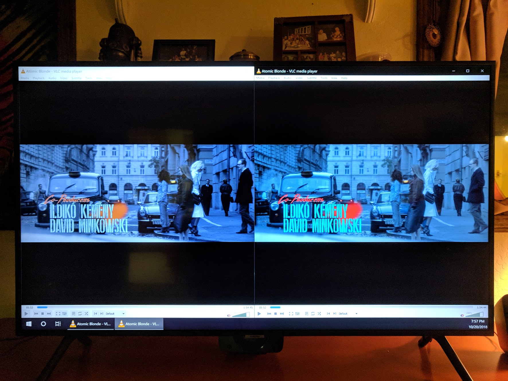

4K UHD rip on the left, regular SDR blu-ray rip on the right:
As you can see, the reds are coming out orange and the deep teal looks washed out.
HDR is enabled on the TV's HDMI port and in Windows 10 for the display.
I don't really actually notice a tremendous difference with HDR on or off other than artifacting in the SDR version when HDR is on.

Note that HDMI 2.0 does not have enough bandwidth to handle RGB (or YCbCr 4:4:4) at 10 bits (which is apparently necessary for HDR) and the result is exactly as you have seen. Note also that this is not just with an HTPC, e.g. if you set an Oppo 203 to RGB (the default is YCbCr) you get the same desaturated colors.
So, try setting your video card to YCbCr 4:2:2. I think that you will find that the problem is fixed. It certainly was for me.

jmonier wrote: Mon Oct 22, 2018 12:56 pm Note that HDMI 2.0 does not have enough bandwidth to handle RGB (or YCbCr 4:4:4) at 10 bits (which is apparently necessary for HDR) and the result is exactly as you have seen.
Really? I thought HDMI 2.1 was for 8 and 10k. How does one normally connect a 4K HDR device if not by HDMI? My TV only has HDMI and USB inputs.
I don't even know what an Oppo is! =]
What problem did this solve for you, the desaturated colors or the screen flashing? I've set mine to YCbCr 4:2:2 and don't get flashes to black but I do tears and bars that occasionally appear. This happens at 8, 10, or 12 bpc and at 50 or 60 Hz. Everything seems to run fine at 30 Hz though. The colors also don't seem any more saturated. Also, I can only set YCbCr444 to 8 bpc, no other options appear.
