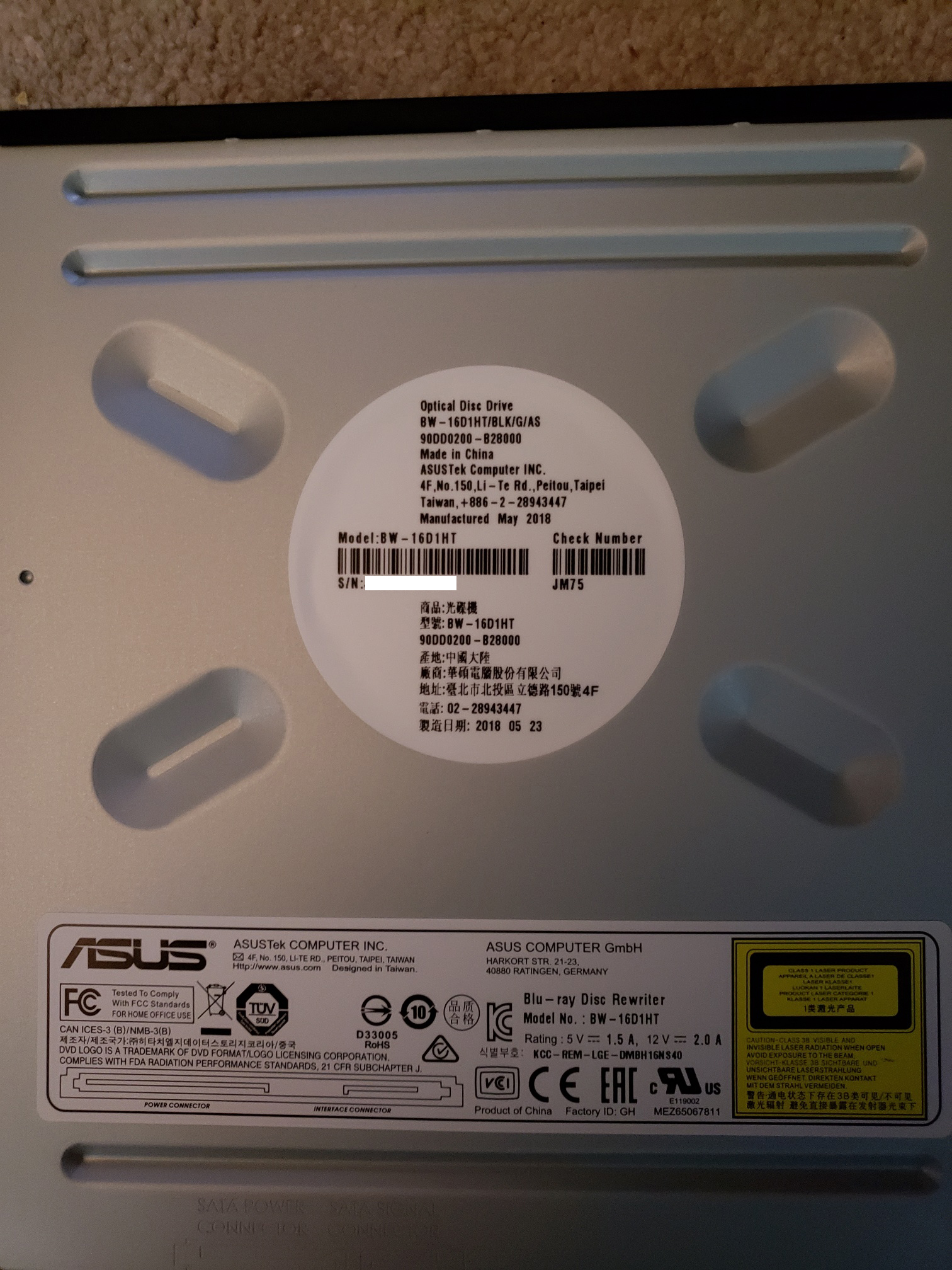

So it seems ASUS has stopped putting(or doesn't to begin with) the SVC code on the label(at least not in Enslish). Just picked this up as a backup to my LG(which works fine). How do I go about checking which version I have or is it relevant since I see that supposedly if it was manufactured after 2015(in this case May 2018), it is a NS50...

1. READ this:Chuck_IV wrote: Sat Sep 08, 2018 6:18 pm So it seems ASUS has stopped putting(or doesn't to begin with) the SVC code on the label(at least not in Enslish). Just picked this up as a backup to my LG(which works fine). How do I go about checking which version I have or is it relevant since I see that supposedly if it was manufactured after 2015(in this case May 2018), it is a NS50...
viewtopic.php?f=16&t=16832&p=65023&hili ... ice#p65023
2. MakeMKV has ALWAYS reported the firmware version of the drive(s) it detects. When you install the drive and view the drive’s info with MakeMKV, what does it say? It’s the only way to find out for sure with Asus drives. But based on that manufacture date alone you may have to downgrade.
Re: UHD drives
Its not so much the firmware I'm worried about(I downgraded my LG). I expect to have to do that. I just want to make sure it's isn't an SVC NS40 drive(vs the correct NS50). But based on what I'm reading, since about 2015, all of these model drives are SVC NS50's(I think).st4evr wrote: Sat Sep 08, 2018 7:15 pm1. READ this:Chuck_IV wrote: Sat Sep 08, 2018 6:18 pm So it seems ASUS has stopped putting(or doesn't to begin with) the SVC code on the label(at least not in Enslish). Just picked this up as a backup to my LG(which works fine). How do I go about checking which version I have or is it relevant since I see that supposedly if it was manufactured after 2015(in this case May 2018), it is a NS50...
- Posts: 5985
Re: UHD drives
you are good you just need to downgrade you have the same LG DMBH16NS40 internal drive as all the asus's that i have flashed so far when that model number changes then its time for us to worryChuck_IV wrote: Sat Sep 08, 2018 9:16 pmIts not so much the firmware I'm worried about(I downgraded my LG). I expect to have to do that. I just want to make sure it's isn't an SVC NS40 drive(vs the correct NS50). But based on what I'm reading, since about 2015, all of these model drives are SVC NS50's(I think).st4evr wrote: Sat Sep 08, 2018 7:15 pm1. READ this:Chuck_IV wrote: Sat Sep 08, 2018 6:18 pm So it seems ASUS has stopped putting(or doesn't to begin with) the SVC code on the label(at least not in Enslish). Just picked this up as a backup to my LG(which works fine). How do I go about checking which version I have or is it relevant since I see that supposedly if it was manufactured after 2015(in this case May 2018), it is a NS50...

SVC codes are not relevant to ASUS drives. They are only for the LG drives. Your ASUS is good if manufactured after 2015 and has firmware 3.00 - 3.01 (or the late 2017 version of 3.02). Firmware version 3.03 is not UHD Friendly and will need to be downgraded.

I mean... Damn I could not have made it clearer with my post (specifically the direct link provided) that “NS” service codes are irrelevant for Asus drives. But I guess some people don’t read now a days.Chuck_IV wrote: Sat Sep 08, 2018 9:16 pmIts not so much the firmware I'm worried about(I downgraded my LG). I expect to have to do that. I just want to make sure it's isn't an SVC NS40 drive(vs the correct NS50). But based on what I'm reading, since about 2015, all of these model drives are SVC NS50's(I think).st4evr wrote: Sat Sep 08, 2018 7:15 pm1. READ this:Chuck_IV wrote: Sat Sep 08, 2018 6:18 pm So it seems ASUS has stopped putting(or doesn't to begin with) the SVC code on the label(at least not in Enslish). Just picked this up as a backup to my LG(which works fine). How do I go about checking which version I have or is it relevant since I see that supposedly if it was manufactured after 2015(in this case May 2018), it is a NS50...
But someone else here already kindly mentioned that as well in a post above anyways. So, just check the firmware and if it’s 3.02 or above just downgrade dude.

Yep, completely missed the link. Was running out the door and posted quickly. My apologies.st4evr wrote: Sun Sep 09, 2018 2:44 amI mean... Damn I could not have made it clearer with my post (specifically the direct link provided) that “NS” service codes are irrelevant for Asus drives. But I guess some people don’t read now a days.Chuck_IV wrote: Sat Sep 08, 2018 9:16 pmIts not so much the firmware I'm worried about(I downgraded my LG). I expect to have to do that. I just want to make sure it's isn't an SVC NS40 drive(vs the correct NS50). But based on what I'm reading, since about 2015, all of these model drives are SVC NS50's(I think).st4evr wrote: Sat Sep 08, 2018 7:15 pm
1. READ this:
2. MakeMKV has ALWAYS reported the firmware version of the drive(s) it detects. When you install the drive and view the drive’s info with MakeMKV, what does it say? It’s the only way to find out for sure with Asus drives. But based on that manufacture date alone you may have to downgrade.![]()
Anyway, I was able to downgrade the Asus drive just fine(using Teddy's guide). And while I was at it, I cross-flashed my LG, which had been running 1.02 to the Asus 3.02 firmware.
