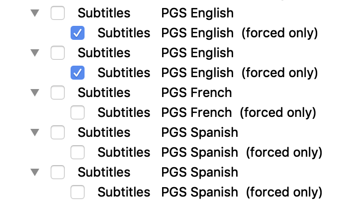

I have around 150 Blu-ray rips, all done within the last year, so I've been using a contemporary version of MakeMKV on the Mac.Chetwood wrote: Thu May 09, 2019 4:25 amWhich is the opposite of pretty much everyone else's experience here. Since almost none of the subs are actually flagged as forced, MakeMKV can not recognize them automatically (unless Mike has changed something in the last versions where he checks for size/number of items).mattyj2001 wrote: Wed May 08, 2019 6:39 am I've also found that MakeMKV is good at picking out the needed subtitles when people speak a different language.
My process is to only select the forced subtitles for the language I want to see on screen (English), like this:
I have my default selection rule set as "-sel:all,+sel:(favlang|nolang),-sel:mvcvideo,=100:all,-10:favlang,-sel:subtitle,+sel:(forced&(eng))"
I'm only interested in the forced English subtitles, not the full subtitles. I don't mix and match. This has resulted in perhaps a 90%+ success rate. The only disks I can think of that didn't work right were the first Bourne movie and any Star Wars disks that have subtitles in them.
Most of the time I end up with zero subtitle tracks, but looking at my list right now I have about 15 films with forced subtitles that I remember off the top of my head and MakeMKV found them all, with the above-mentioned exceptions.
I don't re-process my rips after MakeMKV is done with them, I use them as-is. Players like Kodi, Infuse and VLC correctly show the subtitles.
