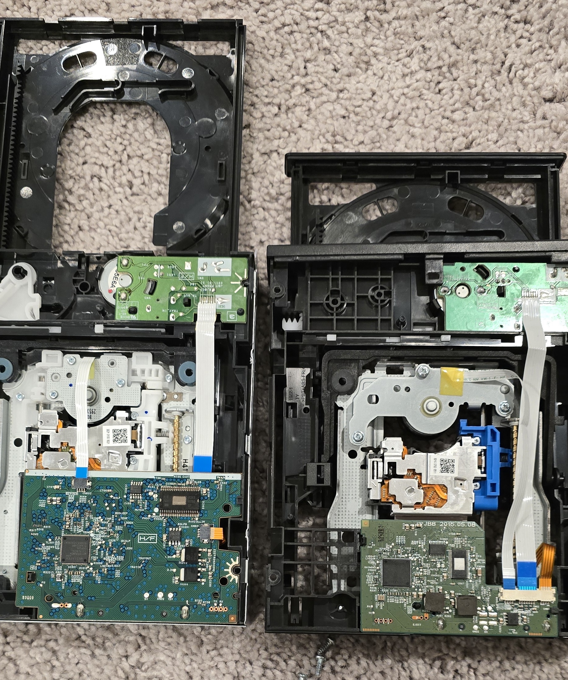

That is a generic case they use to recase rma or drives with issues. The top and bottom are from a DVD drives. Since the guts are pretty much the same they all fit in the same case. Only way to really know if it's a fake is to take off the bottom and see if the main board looks like the one on the right of this picture. That has the MT1959 (on the chip MT1959H) >2016 and the one on the left has the MT 1939 (on the chip MT1959U) <2016.
- 1939_1959.jpg (1.72 MiB) Viewed 11352 times
